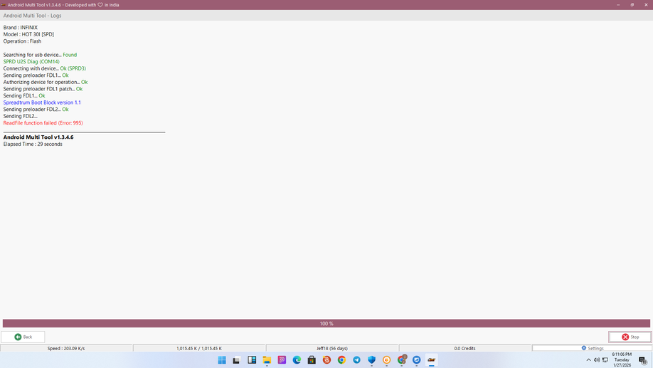

second step - try factory reset sa amt tools search sa amt tools model nya
hot 30i x669d spd at yown hindi namn nabigo success sya sa factory reset
piro steal light indicator lang talaga sya sow naisipan ko flashing at ayun
hindi namn ako nabigo nag success sya sa flashing ito finish pruduct .....
at ito ung pinag basihan ko sa gawa ko mga boss
Brand : INFINIX
Model : HOT 30I [SPD]
Operation : Flash
Searching for usb device... Found
SPRD U2S Diag (COM12)
Connecting with device... Ok (SPRD3)
Sending preloader FDL1... Ok
Authorizing device for operation... Ok
Sending preloader FDL1 patch... Ok
Sending FDL1... Ok
Spreadtrum Boot Block version 1.1
Sending preloader FDL2... Ok
Sending FDL2... Ok
Initializing FDL2... Ok
Reading partition information... Ok [73]
Reading system information...
Rebuilding partition table... Ok
Formatting partition [splloader]... Ok
Reading [l_fixnv1_a] -> [NV_LTE]... Ok
Writing [l_fixnv1_a] -> [qogirl6_pubcp_customer_nvitem.bin]... Ok (Sensitive partition skip)
Reading [prodnv] -> [ProdNV]... Ok
Writing [prodnv] -> [prodnv.img]... Ok
Writing backup [prodnv] -> [ProdNV]... Ok
Reading [miscdata] -> [PhaseCheck]... Ok
Writing backup [miscdata] -> [PhaseCheck]... Ok
Formatting partition [uboot_log]... Ok
Writing [vbmeta_a] -> [vbmeta-sign.img]... Ok
Writing [vbmeta_system_a] -> [vbmeta_system.img]... Ok
Writing [vbmeta_system_ext_a] -> [vbmeta_system_ext.img]... Ok
Writing [vbmeta_vendor_a] -> [vbmeta_vendor.img]... Ok
Writing [vbmeta_product_a] -> [vbmeta_product.img]... Ok
Writing [l_modem_a] -> [SC9600_qogirl6_pubcp_modem.dat]... Ok
Writing [l_deltanv_a] -> [qogirl6_pubcp_customer_deltanv.bin]... Ok
Writing [l_ldsp_a] -> [qogirl6_pubcp_LTEA_DSP.bin]... Ok
Writing [l_gdsp_a] -> [qogirl6_pubcp_DM_DSP.bin]... Ok
Writing [l_agdsp_a] -> [qogirl6_pubcp_AGCP_DSP.bin]... Ok
Writing [pm_sys_a] -> [qogirl6_cm4.bin]... Ok
Writing [gnssmodem_a] -> [PM_QogirL6_gnss_cm4.bin]... Ok
Writing [wcnmodem_a] -> [PM_umw2631_qogirL6.bin]... Ok
Writing [boot_a] -> [boot.img]... Ok
Writing [vendor_boot_a] -> [vendor_boot.img]... Ok
Writing [dtbo_a] -> [dtbo.img]... Ok
Writing [super] -> [super.img]... Ok
Writing [cache] -> [cache.img]... Ok
Formatting partition [tranfs]... Ok
Writing [userdata] -> [userdata.img]... Ok
Writing [logo] -> [logo.bin]... Ok
Writing [fbootlogo] -> [itel_720_1612_24bit.bmp]... Ok
Formatting partition [l_runtimenv1]... Ok
Formatting partition [misc]... Ok
Formatting partition [sysdumpdb]... Ok
Writing [trustos_a] -> [tos-sign.bin]... Ok
Writing [teecfg_a] -> [teecfg-sign.bin]... Ok
Writing [sml_a] -> [sml-sign.bin]... Ok
Writing [uboot_a] -> [u-boot-sign.bin]... Ok
Writing [persist] -> [persist.img]... Ok
Formatting partition [metadata]... Ok
Writing [splloader] -> [u-boot-spl-16k-emmc-sign.bin]... Skip (Different storage)
Writing [splloader] -> [u-boot-spl-16k-ufs-sign.bin]... Ok
NVRAM Backup saved to : C:\Users\SamtecH\Desktop\Backup\SPD_NVRAM_3274031\
Resetting device factory reset protection... Ok
Rebooting device... Ok
Android Multi Tool v1.3.2.5
Elapsed Time : 5 minutes 21 seconds
