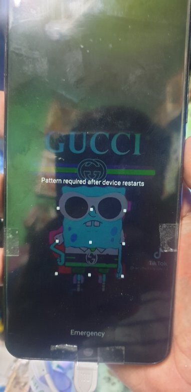

Infinix Hot 9 Play (X680f) Password Problem
Process

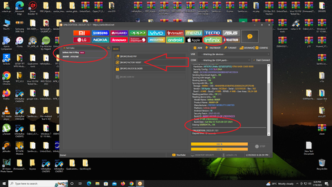

1.Open UnlockTool
2.Select Brand: INFINIX
3.Search: Infinix Hot 9 Play brom
4.Click: [BROM] FACTORY RESET
5.Boot key: Press and hold volume up and down and connect Usb cable and wait it done
SS

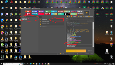

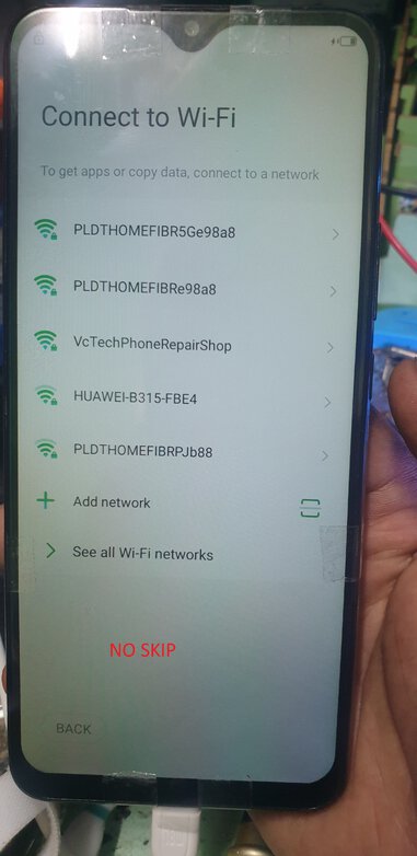

Second FRP Problem
Off phone
Click: [BROM] ERASE FRP
Boot key: press and hold Volume up and down and connect Usb Cable wait until finish

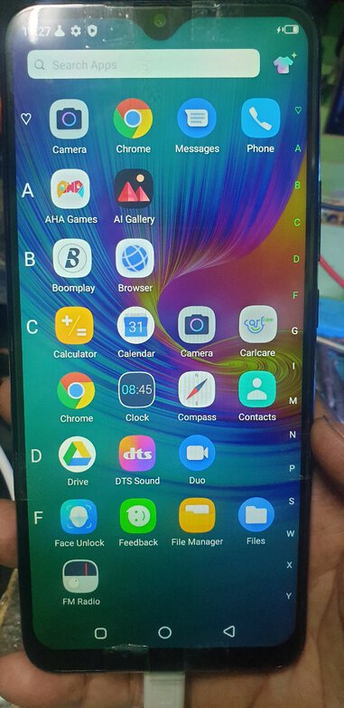

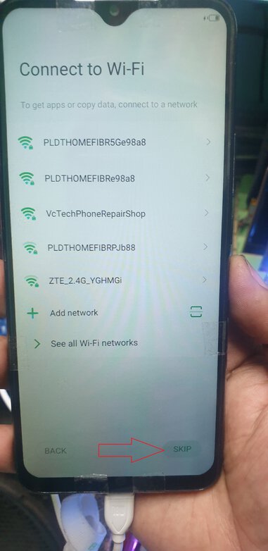

Then setup

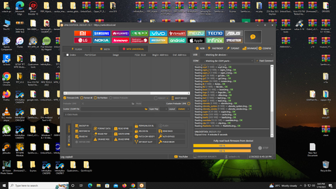

READ BACK Initializing usb... OK
Waiting for device... COM3 [BOOTROM:0E8D:0003]
Bypassing authentication... OK
Analyzing... preloader_x680f_h6116.bin [MT6765:4:752] [Internal]
Handshaking... OK
Reading hardware info... OK
Hardware : MT6765 [Helio G25|G35|P35] 0766 8A00 CA00 0000
Security Config : SCB SLA DAA
MEID : DC35B35A91FE8A266EBE8AEF14CC1D24
Sending Download-Agent... OK
Syncing with target... OK
Booting device... OK
Syncing with DA... OK
Storage : EMMC - CID : 484A0190.61384743.8360A234.2F571348
Vendor : SK Hynix - Name : HCG8a4 - Serial : 323519328 - Rev : 162
Boot1 : 4 MiB - Boot2 : 4 MiB - RPMB : 4 MiB - User Area : 58.24 GiB
Reading partition info... OK [41]
Reading device info... OK

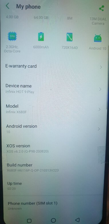

Model Name : Infinix X680F
Product Name : X680F-OP
Manufacturer : INFINIX MOBILITY LIMITED
Platform : Infinix-X680F
Android Version : 10
Security Patch : 2021-03-05
Build ID : X680F-H6116P-Q-OP-210313V223
Build : P-OP-210313V223
Build Date : Sat Mar 13 11:25:38 CST 2021
Reading preloader [512 KiB] -> preloader.bin... OK
Reading pgpt [32 KiB] -> pgpt.bin... OK
Reading boot_para [1 MiB] -> boot_para.bin... OK
Reading proinfo [3 MiB] -> proinfo.bin... OK
Reading para [512 KiB] -> para.bin... OK
Reading expdb [20 MiB] -> expdb.bin... OK
Reading frp [1 MiB] -> frp.bin... OK
Reading metadata [32 MiB] -> metadata.img... OK
Reading md_udc [22.6 MiB] -> md_udc.bin... OK
Reading nvcfg [32 MiB] -> nvcfg.img... OK
Reading nvdata [71.87 MiB] -> nvdata.img... OK
Reading persist [48 MiB] -> persist.img... OK
Reading protect1 [8 MiB] -> protect1.img... OK
Reading protect2 [8 MiB] -> protect2.img... OK
Reading tkv [1 MiB] -> tkv.img... OK
Reading recovery [39 MiB] -> recovery.img... OK
Reading seccfg [8 MiB] -> seccfg.bin... OK
Reading sec1 [2 MiB] -> sec1.bin... OK
Reading md1img [100 MiB] -> md1img.img... OK
Reading spmfw [1 MiB] -> spmfw.img... OK
Reading scp1 [1 MiB] -> scp1.img... OK
Reading scp2 [1 MiB] -> scp2.img... OK
Reading sspm_1 [1 MiB] -> sspm_1.img... OK
Reading sspm_2 [1 MiB] -> sspm_2.img... OK
Reading gz1 [16 MiB] -> gz1.bin... OK
Reading gz2 [16 MiB] -> gz2.img... OK
Reading nvram [64 MiB] -> nvram.img... OK
Reading lk [1 MiB] -> lk.bin... OK
Reading lk2 [1 MiB] -> lk2.bin... OK
Reading boot [32 MiB] -> boot.img... OK
Reading logo [8 MiB] -> logo.bin... OK
Reading dtbo [8 MiB] -> dtbo.img... OK
Reading tee1 [5 MiB] -> tee1.img... OK
Reading tee2 [5 MiB] -> tee2.img... OK
Reading vbmeta [8 MiB] -> vbmeta.img... OK
Reading vbmeta_system [8 MiB] -> vbmeta_system.img... OK
Reading vbmeta_vendor [9 MiB] -> vbmeta_vendor.img... OK
Reading super [4.41 GiB] -> super.img... OK
Reading cache [300 MiB] -> cache.img... OK
Reading tranfs [300 MiB] -> tranfs.img... OK
Reading userdata [52.62 GiB] -> userdata.img... OK
Reading otp [43 MiB] -> otp.img... OK
Reading flashinfo [16 MiB] -> flashinfo.img... OK
UNLOCKTOOL 2023.01.13.1
Elapsed time : 4 minutes 8 seconds
