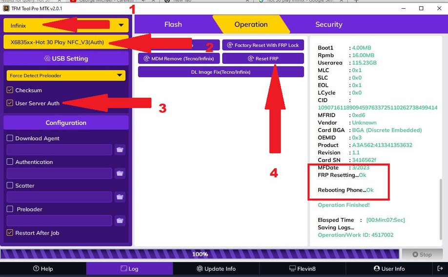

error kay unlocktool latest patch..
pero smooth kay TFM..
nag reset si client kaya lock sa google account..
follow image..
1. set phone brand
2.set model x6835xx ... V3 (auth) na kasi failed sa V1 at V2
3. tick USER SERVER AUTH
4. click RESETFRP
5. insert TYPE C usb boot keys hold volume up and down..

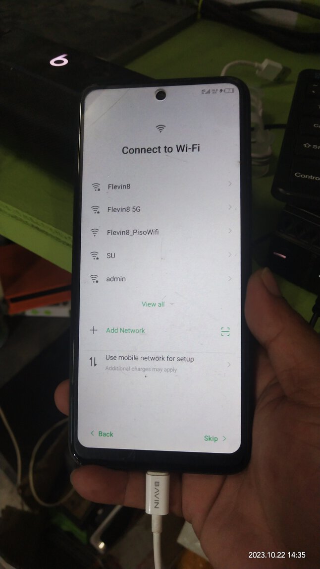

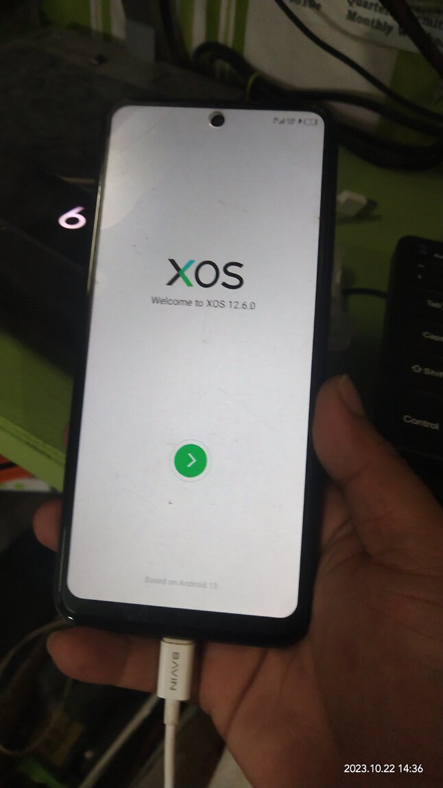

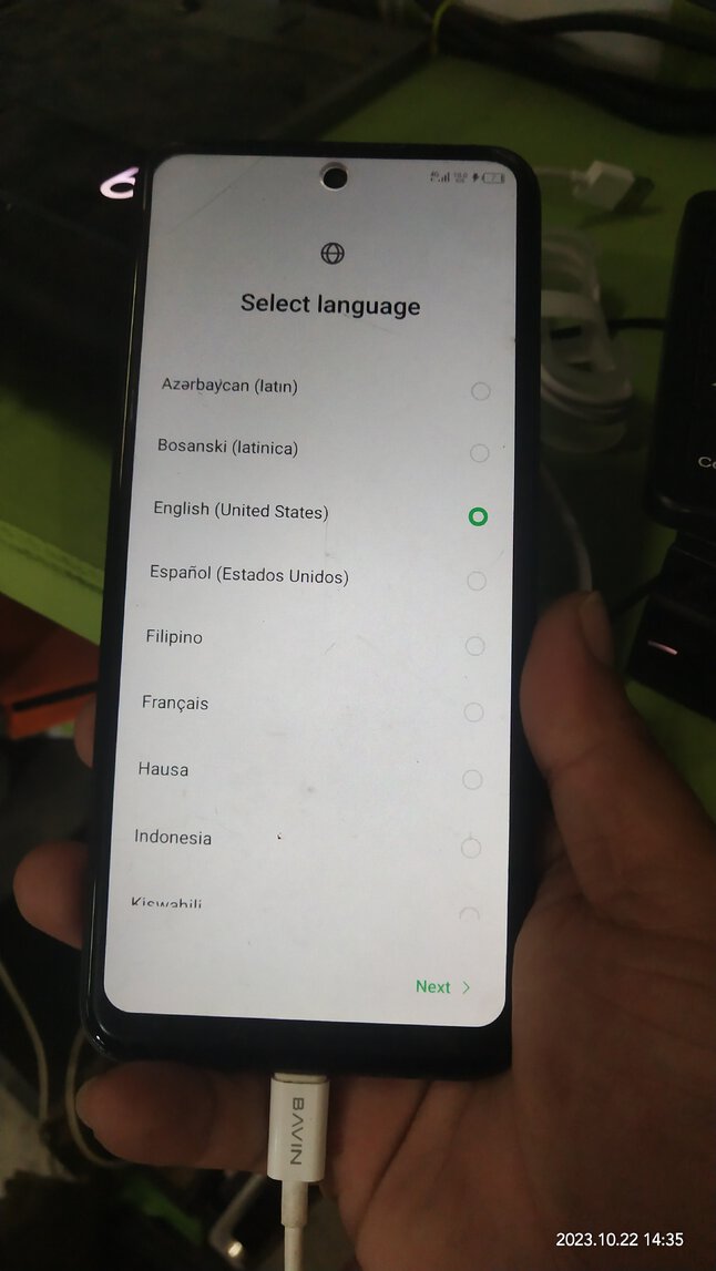

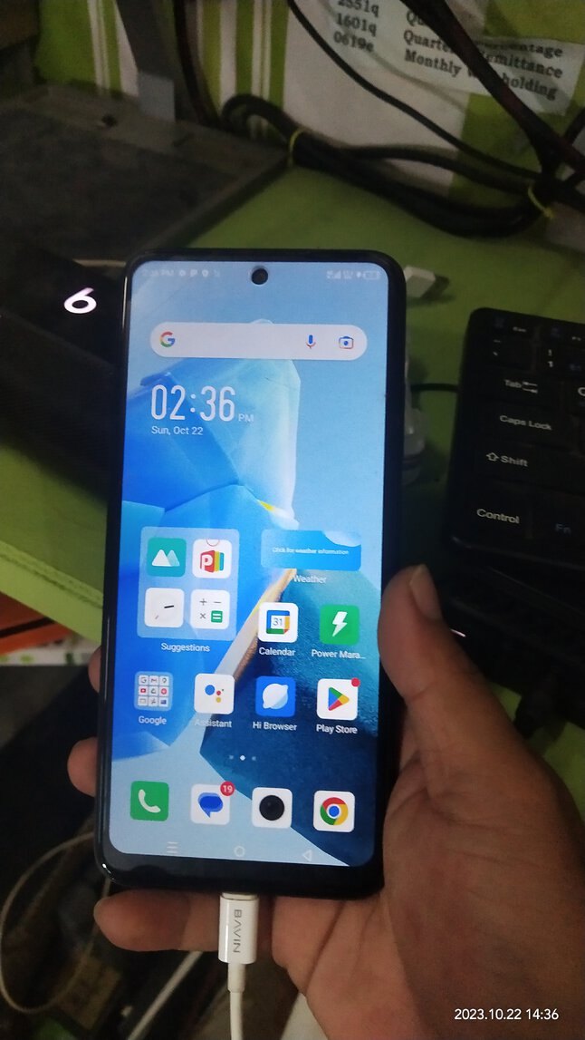

finish set up and done..
