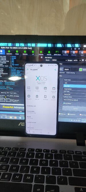

Infinix note 10 pro(X695D)
Frp issue done ki hydra tool
Step open hydra tool
Off unit.
Click mtk
Select brand Infinix
Select model note 10 pro
Click boot info
Hold V+V-
Plug USB cable
Wait until matapus mag boot info wag bunotin then
Select : factory reset protection (frp)
Flash mode: zero wipe
Click execute and wait until done

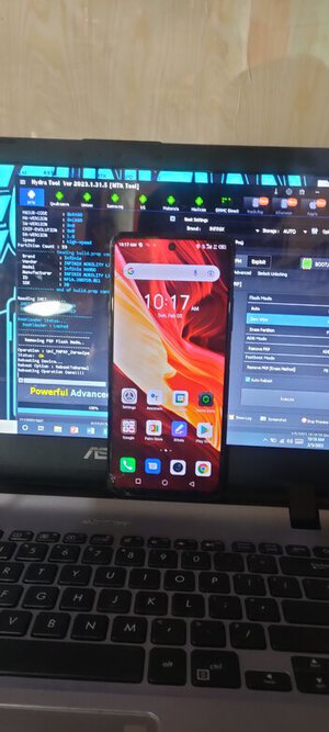

Off unit.
Click mtk
Click boot info
Hold V+V-
Plug USB cable
