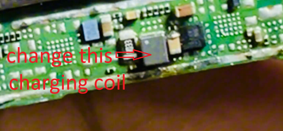

INFINIX SMART 8 FAKE CHARGING DONE
SOLUTION
1 CHANGE CHARGING PIN NEGA
2 JUMPER VBUS CHARGING PIN TO MAIN BOARD NEGA
3 REBALL CHARGING IC NEGA
4 CHANGE CHARGING COIL DONE
IMAGE SOLUTION

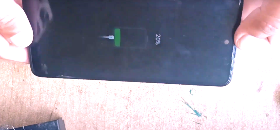

IMAGE SOLUTION
DONE
