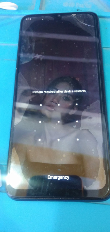

PROBLEM: FORGET PASSWORD AND FRP
TOOLS:
TECHNICIAN
LOPTOP OR DISKTOP
NCKBOX ACTIVATED
MICRO USBCABLE
PROCEDURE : FOR PASSWORD
HARD RESET THE UNIT
press volume up and power button once you see no command then press again power button and volume up in 1seconds to see recovery mode then select wipe data and factory reset then reboot system.

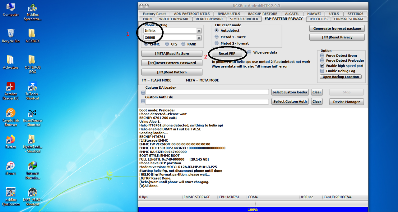

NEXT REMOVE FRP ACCT,
PROCEDURE : FOR FRP
OPEN NCKBOX ADRIOD MTK
select frp pattern privacy
go to phone setting select infinix ( X680B )
click reset FRP
hold vol - down
insert micro usbcable
Wait until done...
