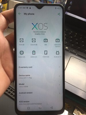

history:
na reset na po ng dinala sakin frp na lang o sa tawag na google account
procedure:
hanap ko mona model ng unit
saksak sa pc silipin sa manager sa device manager ma kikita mo doon model
naka lagay doon X688B
hanap ko sa chrome ano model nia lomabas infinix hot 10 play

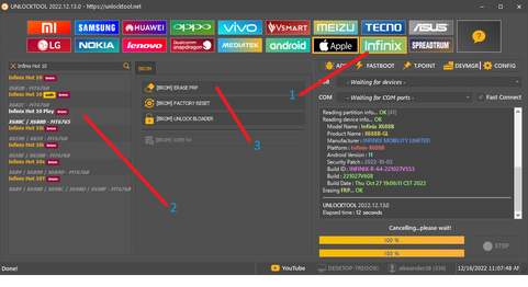

1.open UT tool
2.infinix
3.search hot 10 play x688b
4.install mtk driver dito download ----> all driver UT TOOL free
5.click [BROM] ERASE FRP
6.hold voll up and down saksak sa pc wait.... mag done :D
next2 mo na lang
TOOL log's :
[BROM] ERASE FRP Initializing usb... OK
Waiting for device... COM4 [BOOTROM:0E8D:0003]
Bypassing authentication... OK
Analyzing... preloader_x688b_h659.bin [MT6765:20:3312] [Internal]
Handshaking... OK
Reading hardware info... OK
Hardware : MT6765 [Helio G25|G35|P35] 0766 8A00 CA00 0000
Security Config : SCB SLA DAA
MEID : 9887609EAF224200CA1D194391F36661
Sending Download-Agent... OK
Syncing with target... OK
Booting device... OK
Syncing with DA... OK
Storage : EMMC - CID : 44000115.42443656.E7550242.79C83AD0
Vendor : Samsung - Name : DV6DBB - Serial : 986769237 - Rev : 2
Boot1 : 4 MiB - Boot2 : 4 MiB - RPMB : 16 MiB - User Area : 116.48 GiB
Reading partition info... OK [41]
Reading device info... OK
Model Name : Infinix X688B
Product Name : X688B-GL
Manufacturer : INFINIX MOBILITY LIMITED
Platform : Infinix-X688B
Android Version : 11
Security Patch : 2022-10-05
Build ID : INFINIX-R-64-221027V553
Build : 221027V608
Build Date : Thu Oct 27 19:06:11 CST 2022

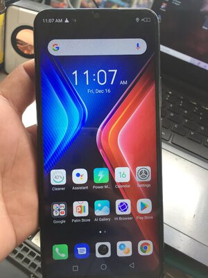

Erasing FRP... OK
UNLOCKTOOL 2022.12.13.0
Elapsed time : 12 seconds
