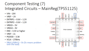

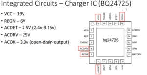

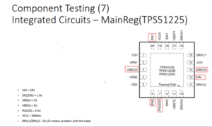

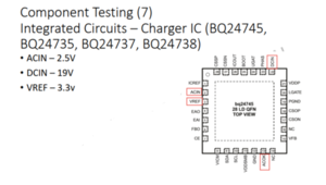

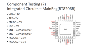

Collections and guide for Main Regulator | Charging IC voltage output for testing
Component IC Testing
To effective test IC we need access to schematic or datasheet
based on where the pin is connected we can predict an approximate value in resistance reading pin to ground it should be kilo ohms range
IC may be deffictive if one pin is reads as shorted
