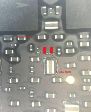

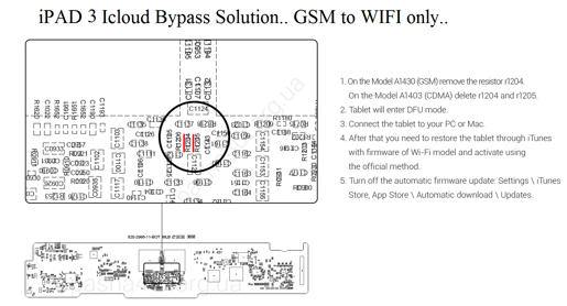

REFERENCE Ipad 3 icloud bypass gsm convert to wifi only
