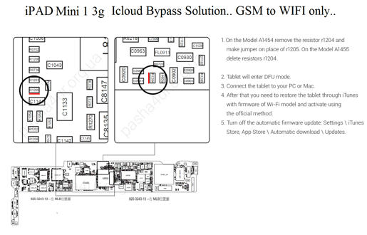

ipad mini icloud bypass A1454 and A1455 cellular/wifi convert to wifi as shown on the image.
https://www.mediafire.com/view/ntvvbul3hjf71iv/ipad_mini_1_3g_icloud_bypass.png/file

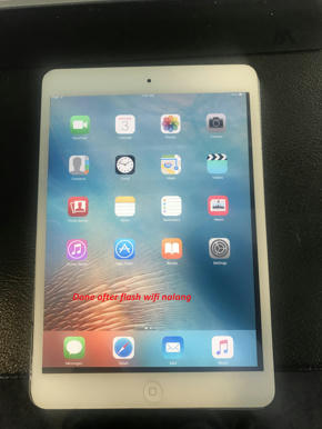

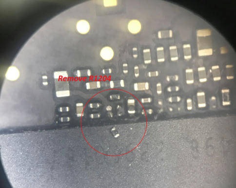

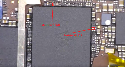

i got one ipad mini 1 wifi cellular A1455. icloud locked as shown on the upper images.
1. need to remove resistor R1204
2. mag-DFU mode na yan kaya flash using itunes or 3utools. with firmware iPad2,5_9.3.5_13G36_Restore.ipsw link below
https://api.ipsw.me/v4/ipsw/download/iPad2,5/13G36
3. after activation di na magwork ang simcard kaya wifi only nalang ang ipad mini. done
