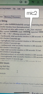

Share ko lang nagawa ko,
full panic missing mic2,
pinalitan ko power flex ok na hindi nag rerestart Pera na✅
Common panic log faults:
mic1 - charging port flex (SE 2020 could be a board issue)
mic2 - power button flex
prs0 - charging port flex
tg0b - battery, battery connector or battery data line
ans2 - NAND related
0x800 - charging port flex
0x1000 - proximity flex
0x1800 - charging port flex & charging port flex
0x400 - sandwich separation
0x80000 - proximity flex
0x40000 - charging port flex
0x10000 - power button flex
0x20000 - sandwich separation
ans2 - NAND related
