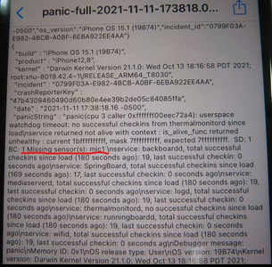

Random rebooting (usually after ~3 minutes after boot)iPhone 11 models require certain sensors to be detected by the operating system, otherwise it will reboot every 3 minutes & record this error in the panic log.
For iPhone 11, there are 3 sensors that must be detected.
On the Charging Port, there is:
  • Mic1
  • Prs0
On the Power Button Flex, there is:
  • MIc2
To find the panic log on the device, go to Settings-> Privacy-> Analytics & Improvements-> Analytics Data-> Scroll down to the files starting with "panic-full..." & click on the most top one.
Example of a Panic Log
image_2022-10-31_033424836.pngAlternatively, you can use a tool like the iDevice Panic Log Analyzer, which will download the panic logs from the device & display them on the PC & give you suggestions to possible solutions. It makes it easier to browse the panic log file.
If you find the above errors, replace the appropriate flex with an OEM or Premium flex.

  • For iPhone 11, you may run into a scenario where there is sandwich separation causing the REARMIC2 line to be disconnected from the bottom board, causing the phone not to detect it & causing the phone to restart every 3 minutes.
    • You'll need to split the sandwich and check for broken REARMIC2 pads. If so, scratch out the vias, solder some solder lug disks & resandwich. Then test again.
Please note: You MUST have the required flex cables, Power Button & Charging Port, plugged in. Otherwise it WILL restart. You cannot troubleshoot this step by unplugging the bad flex.
See this video for a full tutorial on reading the panic logs & how to use the iDevice Panic Log Analyzer tool: https://www.youtube.com/watch?v=QaJLYbtuCGA

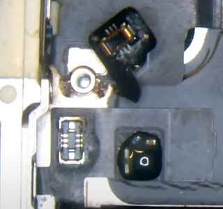

Flex Cables:
  • Step 1 in this case is always unplug all the flex cables.
  • Ideally test the board with known good Screen, Battery & Charging Port.
  • If it boots, then one of your flexes is the cause.
    • 99% of the time, it is the ear speaker flex. The Flood Illuminator and/or the ALS has liquid damage.
    • The ear speaker flex is paired to the logic board for Face ID.
    • If you want to keep Face ID, you'll need to repair the flex. If Face ID is not important, then you can just replace the flex.
      • To repair the flex, you'll have to desolder the component & clean out all the corrosion, then place them back.
      • If the corrosion is too severe & it damaged the flex, then you'll need to swap the Flood Illuminator and ALS to a new flex, otherwise, you'll lose Face ID.
    • In some cases, another flex can cause this issue like a bad charging port.
      • In this case, just replace the flex

Backlight
Or Partial Backlight
You'll want to check these first to confirm you have a board issue:​
  • Get a known good screen — Helps validate that you have a board issue.
  • Check USB Charging Current — If an iPhone shows proper charging current (≈1 A via USB or more), then mostly likely the device is alive.
  • Listen to for any sounds or vibration — Helps confirm if the phone powers on.
  • Turn off the phone, then plug in the charger and use a flashlight onto the center of the screen, to look for the Apple logo — This helps confirm you are getting image, but no backlight.
  • Check for water damage. Often times, the backlight circuit gets hit the hardest in water damage cases.
Solution​
In most cases, no backlight is caused by blown resistors/filters on the backlight circuit.
Please Note: The backlight circuit on the iPhone 11 is underneath a shield. This shield is difficult to remove while the top layer is on the sandwich. It is easier to split the sandwich, work on the top layer to do all the repairs & then re-sandwich the board, to avoid any warping or disturbance to the sandwich.
Here's a video of what can happen if you try to remove that shield without splitting the sandwich: https://youtu.be/1dUuwvpBT-Q
These resistors/filters are the most common to blow:
  • R5730
  • R5733
Sometimes, a broken backlight coil can cause it.
  • M5500A
  • M5500B
You'll need to use Diode mode on your multimeter to find the blown filter. (see video for the full process of diagnosing the backlight: https://www.youtube.com/watch?v=K-FFSMiHXPw)
Since backlight comes from the LCD connector, this is the connector you want to check the diode mode readings. Essentially, you're comparing the diode mode values of a known good board vs your problematic board. Most boardview software, like ZXW, will provide the known good diode mode values and you can use that as reference. Expect to see a small ±5–10% variance of what you get.
With a backlight issue, you should find a pin on the LCD connector to read OL, when it should be giving you a diode mode reading. This line with the OL is what you want to investigate further.
These are the lines to expect to find an issue:
  • PP_DISPLAY_BL12_ANODE
  • PP_DISPLAY_BL34_ANODE
Also, sometimes, you can get lucky and visually spot the blown filter, but it's recommended to use your multimeter to confirm it's bad, as well as check the rest are good.
  • A good/working filter will have continuity across it and will have the same diode mode reading on both sides
  • A blown filter will not have continuity across it. In diode mode, you'll find one side has a diode mode reading and the other side will have either OL or a reading that is a larger value than what it should be.
The replacement filter should be the same value of the original. You can see the values in the schematic or boardview software like ZXW.
Please Note: Never use a jumper wire as a replacement for a filter. This can permanently damage the phone if a surge in current occurs and there's no filter to protect the circuit.
Once you replace the filter, check that you be able to diode mode the connector again and find that the pin that was reading OL, is now giving you a proper reading.
Now you can test again and confirm the backlight is working again.
