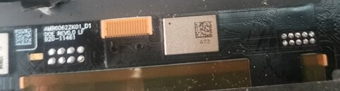

Share ko lang common issue 13 pro green screen.
Solution and Screenshots:
Just make jumper on pin # 8 from left and pin # 6 from right.
Dont forget to put 100ohms resistor and put UV mask ink to protect them.
Scrap board ko para sa 100ohms is iphone 6 with R3309.
Credits kay sir pogi intoy sa thread nya for my reference >>> https://pinoytechnician.com/threads/iphone13-pro-whitescreen-solution-with-resistor.236042/
Done!!
Thanks for viewing!
