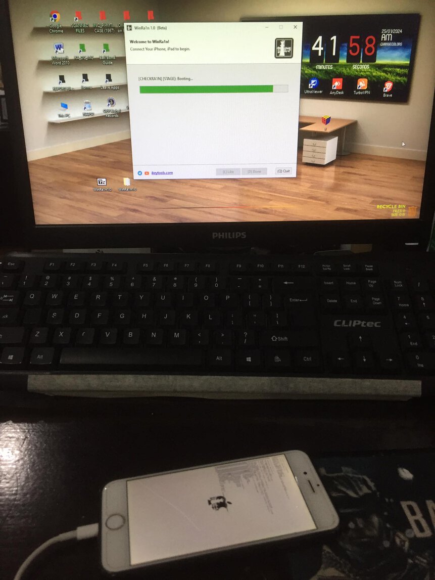

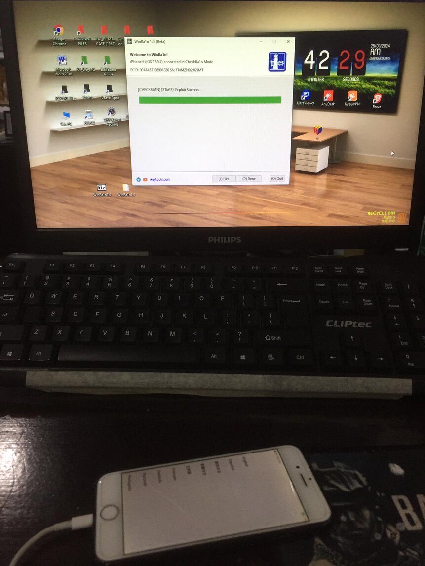

>Jailbreak ko first unit using (WinRa1n V1.0)
Link=> (WinRa1n V1.0)
Follow the Simple Steps sa pag jailbreak na makikita at sundan lang ang sabi sa tool,
Wait the process at lalabas..."Exploit Success!"

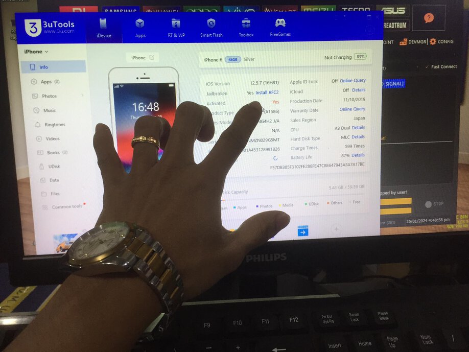

>Open 3uTools to check if Already unit success JailBroken: "YES"

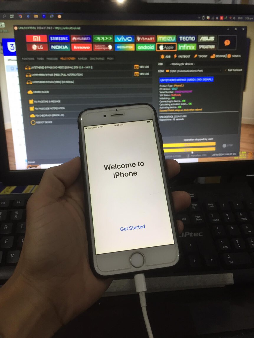

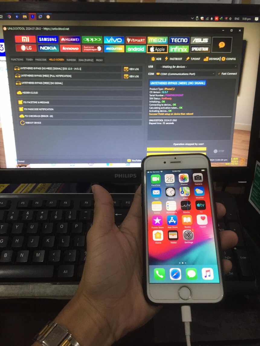

>Open Unlocktool =>Apple Tab =>HELLO SCREEN;
>Choose UNTHETERED BYPASS MEID [NO SIGNAL]
>Wait process until 100%...Done in 15 seconds
>Pop-up Message
"CONFIRMATION" MEID bypass success? Do you want to fix Notification?
Yes No
>Select NO;
>Done...and do the Setup the mobile kana;​

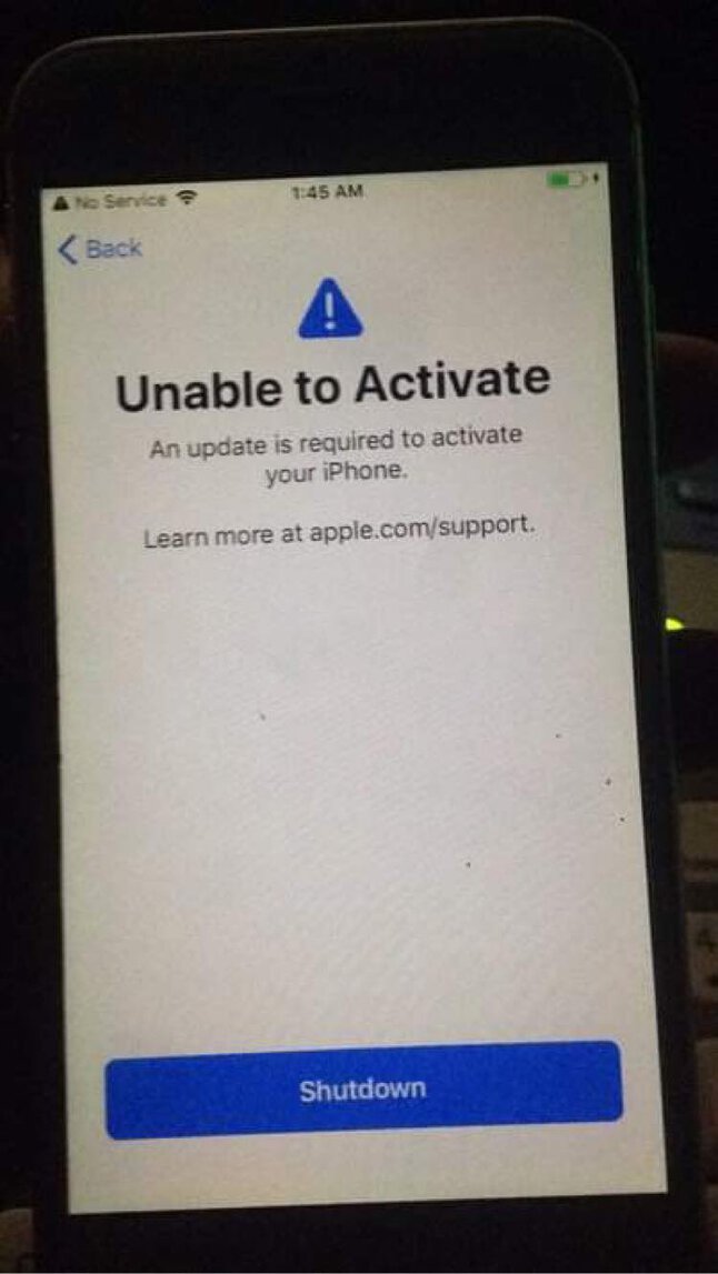

boss bakit yung akin pag ni restart bumabalik sa hillo..?
JB mo sir..pag success na tirahin sa UT..gamit winra1n see the post sa version na gamit ko..pag failed
try use JB using flashdrive, gawa ka ng UFD Bootable ni checkrai1n, may nagtanong sa akin bago pa nag nega sa winra1n baka iba version gamit, kaya pinasubok ko sa Bootable make nag Success din naman
