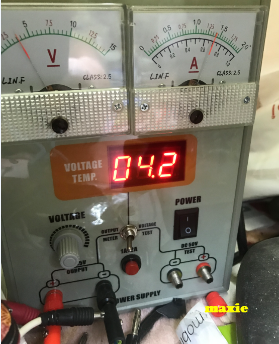

Diagnoses : too high!! ampere consumption or over voltage or ano pa man tawag nyo jan kayo na mag intindi meron namang litrato sa baba,

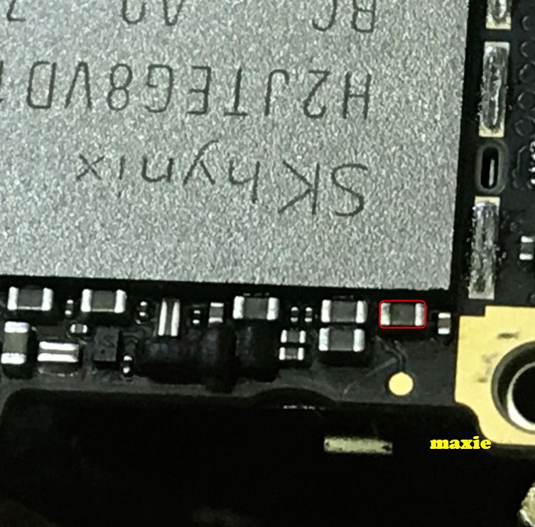

Solution: remove and replace C0634 value 6.3v 15uf

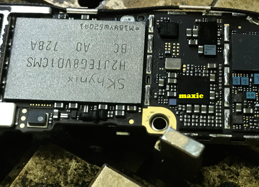

Busted:

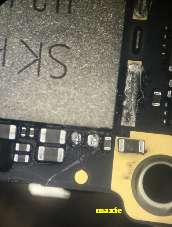

Remove and replace :
Finish :
