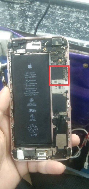

brixgsm Registered Joined Jan 19, 2022 Messages 221 Reaction score 269 Points 1 Location new corella Dec 28, 2022 #1 Mga boss anong ic ito umiinit kasi tapos nagrerestart every minute iphone 6 plus
J j4m2_6 Registered Joined Apr 27, 2021 Messages 1,435 Reaction score 2,967 Points 341 Location La Union ™️ ( Region 1 ) Dec 28, 2022 #2 brixgsm said: Mga boss anong ic ito umiinit kasi tapos nagrerestart every minute iphone 6 plus View attachment 16656 Click to expand... CPU A8 yn Boss ?

dsasfx Registered Joined Dec 2, 2020 Messages 71 Reaction score 36 Points 201 Location balanga, bataan Jul 19, 2023 #3 mag rrestart tlaga.. dpat my cover yan at thermal.. pg n reach ksi ang temp.. matic mag rrestart talaga..

G Gizmobile Moderator Staff member Joined Aug 20, 2020 Messages 87 Reaction score 98 Points 1 Location Elnido Palawan Jul 19, 2023 #4 Normal iinit cpu Check bsi line ng battery Salpak 3u tool kung na dedetect battery health ng battery mo
