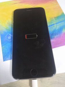

cedie357 Registered Joined Jul 12, 2022 Messages 96 Reaction score 41 Points 1 Location Centrium Hong kong Jul 14, 2022 #1 ganyan lang po siya. gaya ng nasa pic. pero hindi nman nag iinit. any solutions, tnx in advance Attachments iphone 6s not charging.jpg 29.8 KB · Views: 12
Regie214 Registered Joined Mar 8, 2016 Messages 56 Reaction score 4 Points 1 Location Makati Jul 25, 2022 #2 pinalitan mo n ba ng battery?
A AkeishaFix Registered Joined Nov 29, 2014 Messages 62 Reaction score 11 Points 1 Location Bankers, Quirino HiWay, North East Caloocan Jul 25, 2022 #3 try sa basic palit charger fast chager gamitin ibang battery charging port/flex test charging flex kung meron ba 5v kung meron u2 ic or tigris bago magpalit check kung may voltage present ba sa paligid ng u2 at tigris
cedie357 Registered Joined Jul 12, 2022 Messages 96 Reaction score 41 Points 1 Location Centrium Hong kong Jul 31, 2022 #4 AkeishaFix said: try sa basic palit charger fast chager gamitin ibang battery charging port/flex test charging flex kung meron ba 5v kung meron u2 ic or tigris bago magpalit check kung may voltage present ba sa paligid ng u2 at tigris Click to expand... ok sir. try ko pag bumalik si customer.. salamat
taotiang Registered Joined Apr 8, 2017 Messages 56 Reaction score 18 Points 201 Location BASILAN ISABELA CITY Aug 1, 2022 #5 shock mo battery ok nayan.. d lang kaya buhayin kasi drained ang batt
