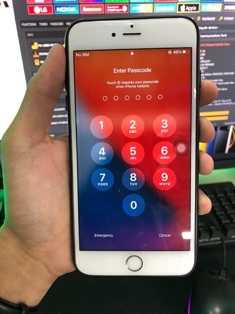

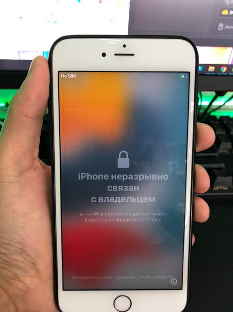

iPhone 6s Plus Before

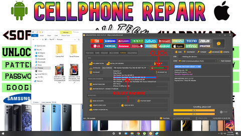

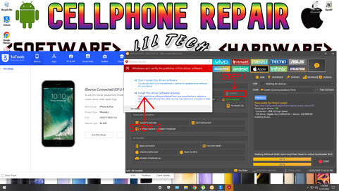

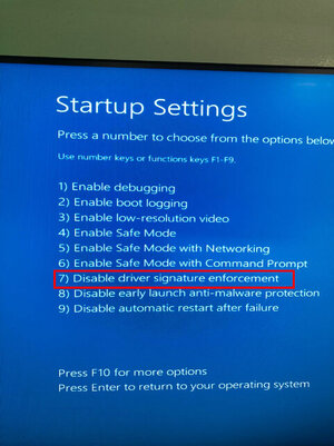

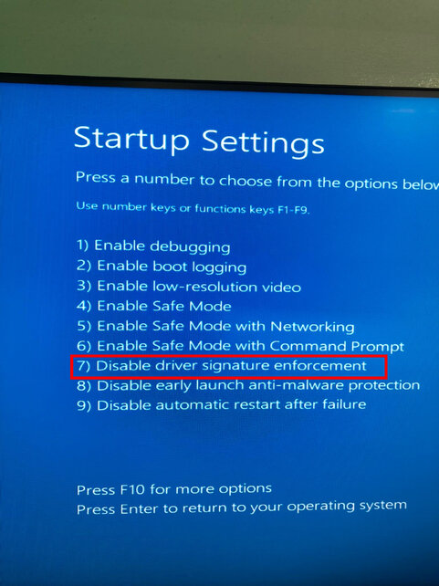

Step 1: Disable Driver signature enforcement Para sure na walang error pag dating sa PWNDFU

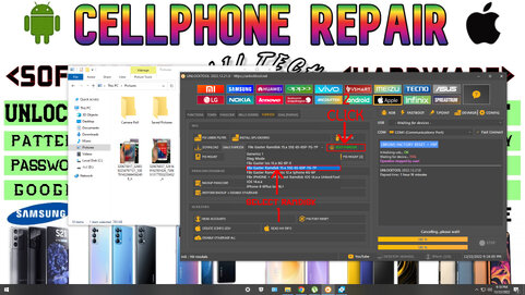

Step 2: Open Unlocktool then enter iphone to DFU Mode salpak sa PC Click PWNDFU wait until done.

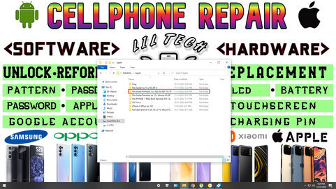

Step 3: Select ramdisk yung File Gaster na may 6s/6s Plus located yon sa Unlocktool Data Files then wait until done.

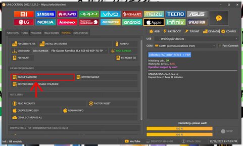

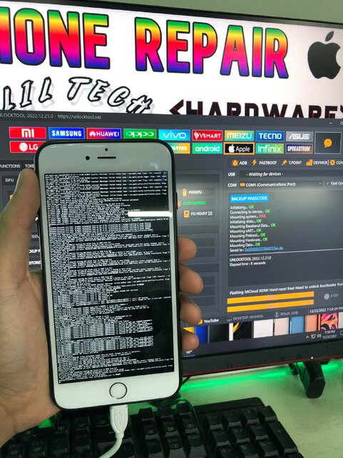

Step 4: Click Backup passcode wait until done.
319843488_668955818101586_8174763910500416088_n(3).jpg320605701_688631462654925_6706153691392921755_n.jpg

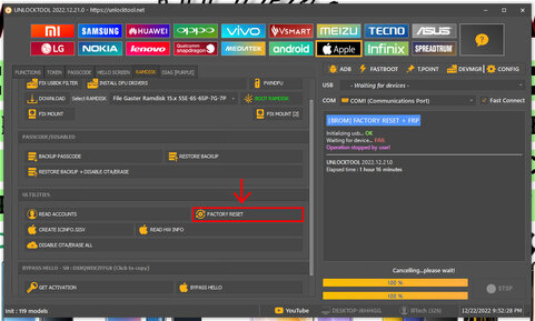

Step 5: Click Factory Reset, double check muna sa backup files kung na backup talaga.

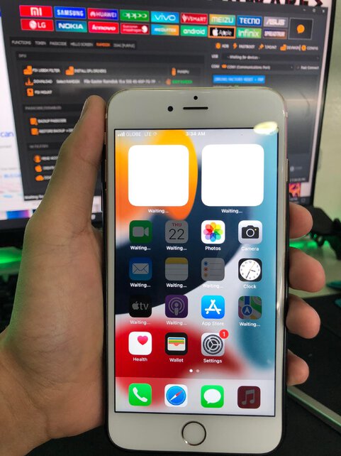

Last Step: Pagtapos ng BOOT RAMDISK sunod RESTORE BACKUP wait until done.
DONE. sana sundan nyo ng tama yung procedure sana nakatulong.:D

thank you boss gumana
