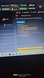

1. open unlock tools tapos click mo get activation
2. tapos may lalabas dyan na need mo palitan serial number para ma backup yung naka hello screen
3. hanap ka lang nang change serial number sa google dun ako nakakita software
4. need mo usb kahit 8gb lang para gumawa ng bootable ng Pwndfu
5. pag naka gawa kana e boot mo sa boot menu then select mo yun Flash drive mo
6. kailangan e dfu para ma checkm8
4. pag na checkm8 na open mo yung software na change serial number tapos e purple mode mo
5. then once na purple mode na click mo open port
6. tapos input mo yung serial number sa unlock tools at e lagay dun sa change serial number, at e click mo yung change serial number.
7. 5-6 balik ka then after nyan open mo unlock tools then click boot ramdisk 1 after mag success click mo yung bypass hello screen at violaaa okay na phone mo singilin muna si tomer :D. sana po ma gets nyo guide ko mga ka ant.
if meron porblema sa pag bypass comment nyo lang at para ma replyan ko salamat po. magandang gabi sa lahat mga ka ant ^^

dagdag ko narin eto boss..unahin muna change serial bago ang get activation
first we need irepair box or any tool that can change serial number
put phone into dfu mode,once detected click dfu mode
replace serial number use this FCHP606DG07R then write
tick exit recovery from irepair
next,run unlocktool
go to apple tab
ramdisk tab
connect iphone in normal mode
tick get activation.
we must see this >>> activating with server..ok <<<
put phone again into dfu mode
next step
pwned dfu for ios 15 to detect dfu mode
pwned dfu iso file : https://www.mediafire.com/file/oti5asicl7f33cl/Build_usb_Run_Checkm8.rar/file
use unetbootin,load iso file P0WN-DFU ,select drive c
tick start til finished
next reboot pc..after reboot select unetbootin
phone must be dfu mode..plug ios cable
at checkm8
hold alt+f2
look for the message " device is already in pwned dfu mode" thats ok..
hold ctrl+alt+del to restart pc
dont do anything to phone ( leave it in pwned dfu mode )
run again unlocktool
download data files : https://www.mediafire.com/file/uj1ebwfg9nkfdqo/Data_Iphone_Boot_Ramdisk_1_Ios15_UnlockTool.rar/file
extract all file in folder C:\UnlockTool\DataFiles\Apple
click boot ramdisk
sometimes it tooks about 10 to 15 mins just wait til
booting ramdisk results ok.
final click bypass hello
https://www.mediafire.com/folder/br777londowj3/Driver-UnlockTool

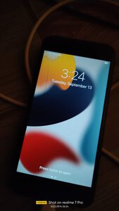

Sinunod ko n ung guide successful pero no service
