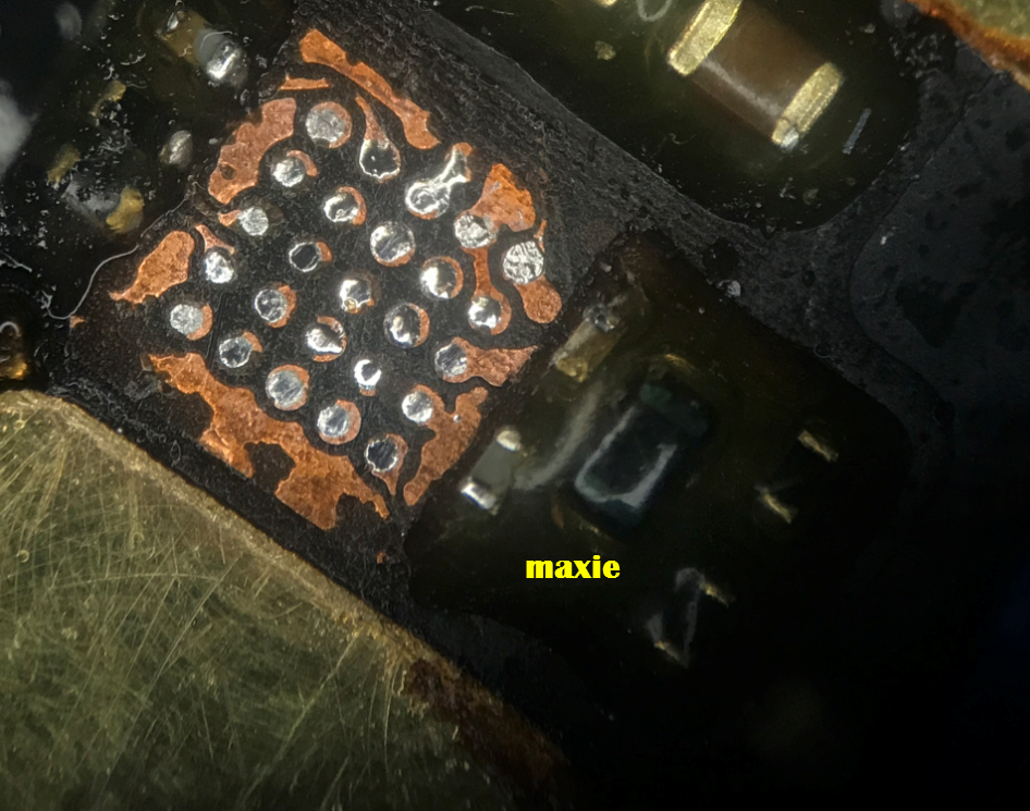

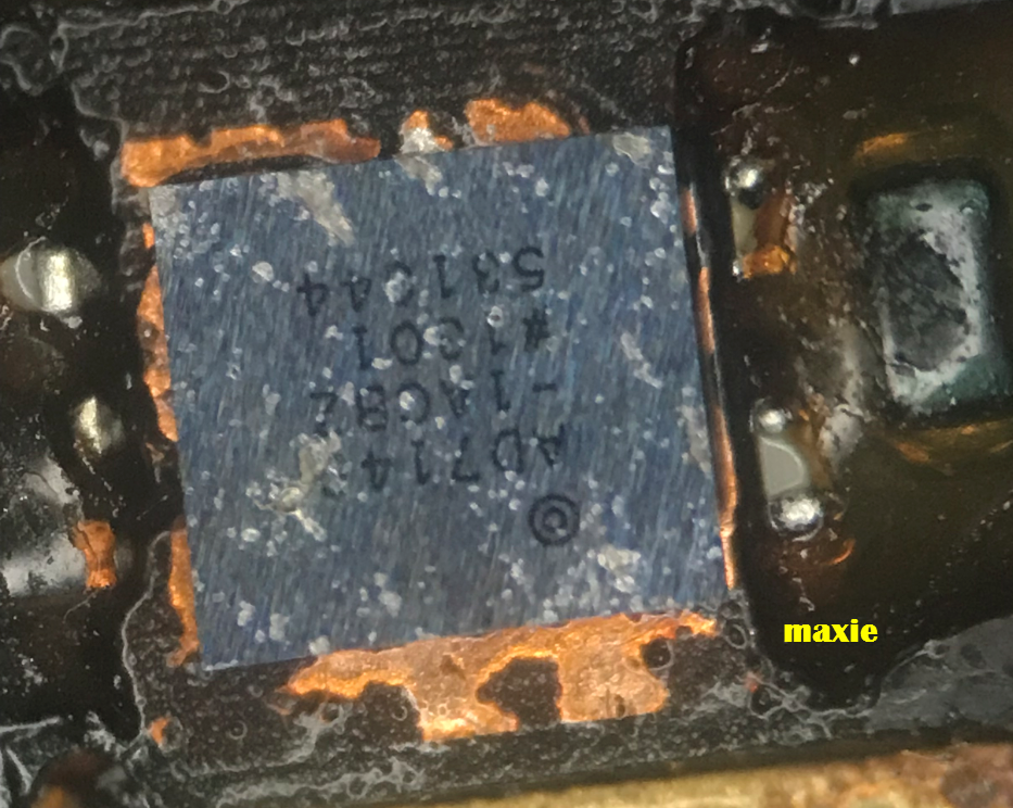

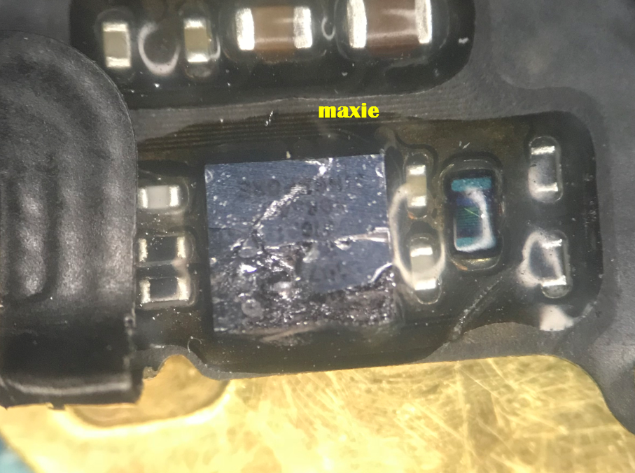

hi
Unit : iphone 7
Problem : stuck on logo
Diagnoses : finger Print not Working
solution : change AD7149 or U10 ic
mga larawan
Before
after remove and cleaning
lapag na yong IC
and finally
Paala ala palagi, hindi po lahat na error 9 ay yan na yong solution, ugaliin na e check ng mabuti
