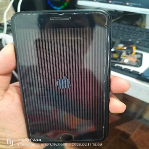

Model : IPHONE 7 PLUS
Problem : Striped Display (Horizontal Lines)
Nakailang testing na din ng bagong LCD,

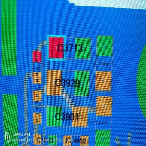

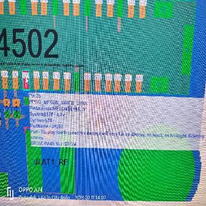

Ginawa ko, bukas unit then DIODE READING sa LCD TERMINAL.
PP5V7_MESON_AVDDH_CONN abnormal reading, which is responsible for display
Akala ko U3703 (chestnut) na my salarin, pero hindi pala,
upon deeply checking Resistors and Capsitors na connected,
nakita ko na ang C3713 Caps ang may kasalan, (shorted caps)
Pull-out Caps, Diode Read sa PP5V7_MESON_AVDDH_CONN balik normal ang value.

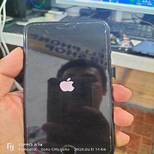

Assemble ang unit and testing.

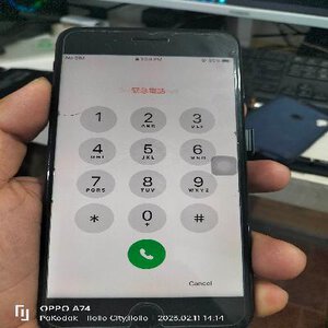

Ayun at gumana.
Normal na ulit ang display.
