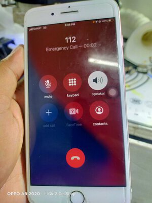

Share ko lng po recieve ko ngayun iPhone 7Plus no loud speaker and no mic issue :cool:

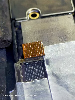

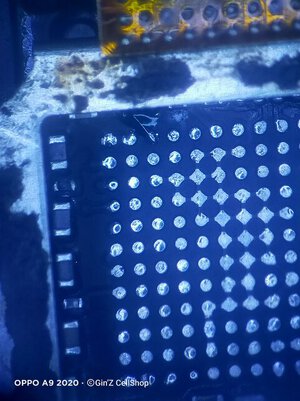

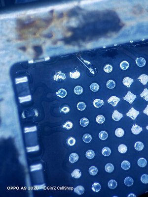

remove ko audio ic at check I2S_AP_TO_CODEC_MCLK line at nakita ko wala nman putol pero nag lagay parin ako jumper para iwas backjob

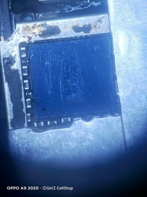

after lagay nang jumper proceed sa reballing nang audio ic at install :cool:

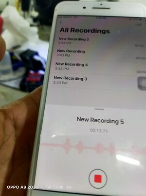

at ito na po sya may recording na at ma pindot na dn ang loud speaker :cool:
done po :cool:
