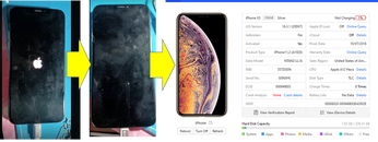

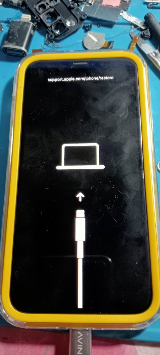

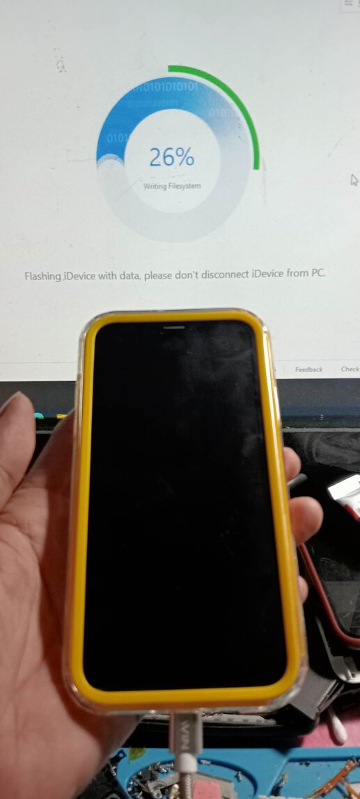

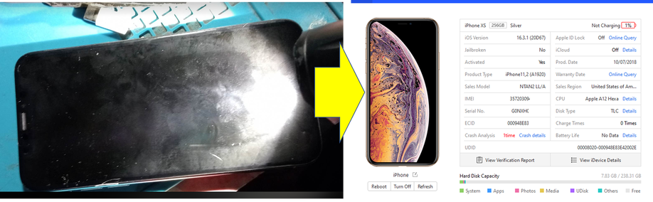

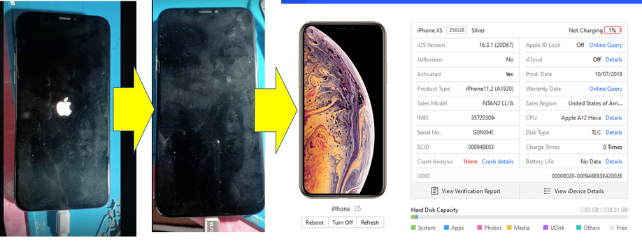

Mga dol any solution Bka May nka encounter ng ganito.
Pagawa ni tomer no display kala ko LCD,
Test ko sa New LCD No luck.
Quick flash s 3UTOOL No luck. Logo at recovery mode meron, success nman s flashing.

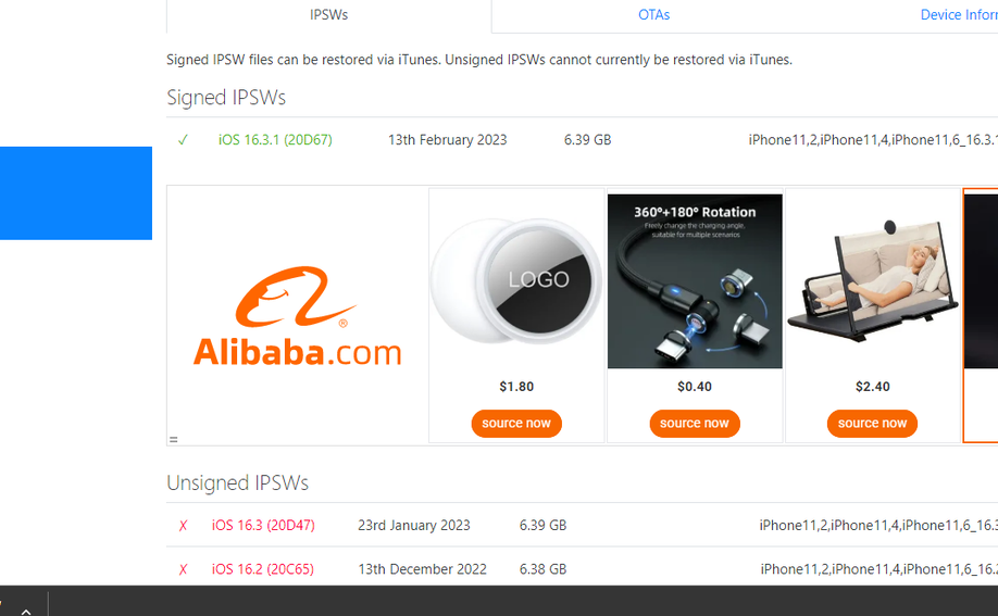

Downgrade ko sana Unsigned IOS na.
Ask ko si tomer ano history, sbi nya nag update lang daw sya IOS Bigla nlang nagkaganyan..
Ano possible issue mga dol?
View attachment 20013View attachment 20014View attachment 20015
restore mo new version dol wag na downgrade ok naman ang 16.3.2 na ngayon...

Salamat dol s support.
mga basic n ngawa ko before.
First Day:
1. Test New LCD No luck.
2. Test with New Battery No luck.
3. Tester ko muna kung may shorted wla naman.
4. Dahil ang kwento ni customer ay Pag update nya daw bigla nlang nagkagayan, So try 3utools restore, Retain, Quick at itunes restore succes nman pero No luck parin.
2nd Day:
1. Salpak sa PC After nag logo at nung nwala logo basa nman 3utools Buhay

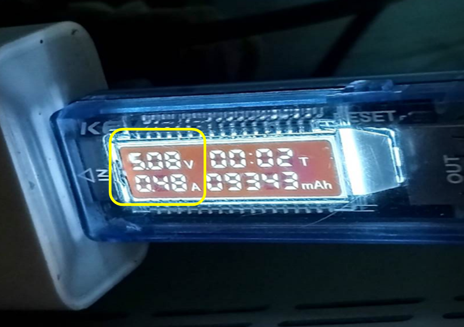

2. Wala akong charging schematic product, temporary gamit ko USB universal Charging pra mcheck din current
Pumapalo hanggang 0.70amp yan

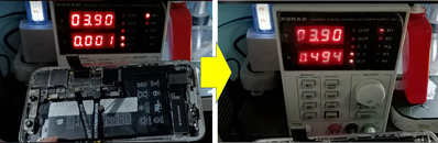

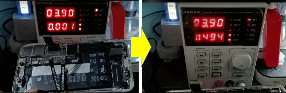

3. Using boot cable (Now ko lng din nsubukan dol ksi nka focus p ako s sinabi ni tomer n history)

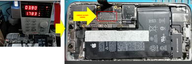

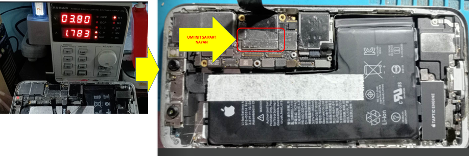

Salpak boot cable power supply On wla shorted, Next power On ko unit pumalo as normal,
Pero after mga 2-3minutes ata biglang oh parang semi-shorted at umiinit s part nyan.

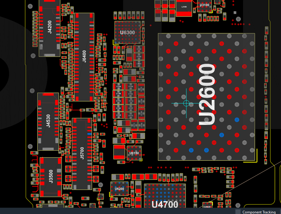

Tanong dol diko kbisado pa ksi to, mAy Display IC or Backlight IC b s part n yan.
First Day:
2nd Day:
ah nga pla dol. dko pa pla nsama flash light hehe, wla rin display khit i flash light ko dol.
