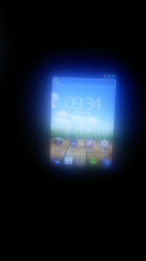

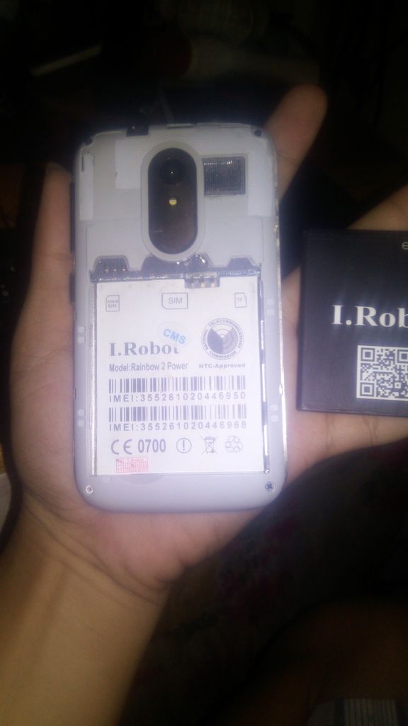

hang on irobot logo ng dnala sakin..
buti may isang cp ako d2 na parehas ung unit kaya nag backup ako gamit
miracle crack at ginamit ko po bin file nya may error po kc sa scatter nya eto po logs ng gamitin kuna yung bin file
MT657x ANDROID NFB File:
The File Information:
ZTESZ15_CU_ICS_PCB01_GPRS_MT6575_S01.MAUI_11AMD_W11_50_SP_V29.BIN_FLNPF38F5060M0Y3DG
1. Power Off Phone , Remove Battery, Insert Battery Back
2. Insert USB cable. In some cases Required Hold BootKey
3. Use Miracle Boot Key In cases Boot key not Find
4. Battery Should be Charged more then 50%
Open Port Err:
*** the Port be occupied.
Waiting for USB Port...
Set MediaTek PreLoader USB VCOM Port (COM11)
Please Hold "ON" to connect with the phone...
Connected to Phone.
CPU: MT6575 SW: E201 Ver: CB00
Downloading Boot8 ...
Nand Flash Type: Nand_NEW_006E
Nand Flash Code: 002C00BC(00900055)
Nand Flash Size: 0x20000000 Hex Bytes
INT/EXT RAM Size: 0xC4800+0x0
Writing(Nand/eMMC)...
Writing UBOOT
Writing BOOTIMG
Writing RECOVERY
Writing SEC_RO
Writing LOGO
Writing ANDROID
Writing USRDATA
Write Done.
>>Total time: 21 mins 31 s
eto na po sya pagkatapos
ok lahat imei at signal
pagkatapos po e hard rest lang po natin
kc mag hang parin yan dahil sa user data
press volume down and power lang hanggang
makita si android at alam muna gagawin next
