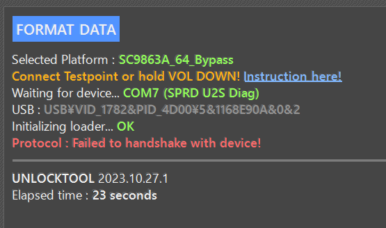

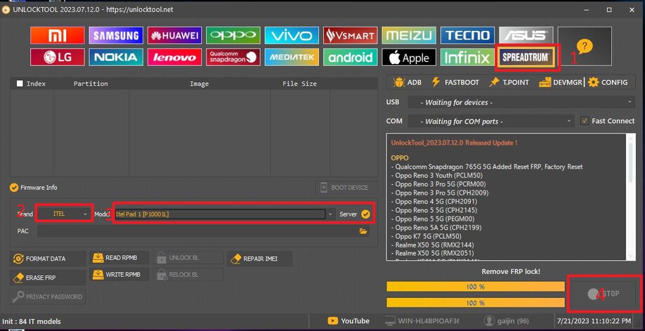

Solution :
Open Unlock Tool
go to spredtrum
click server
brand Itel
Select Model Itel pad 1 (p10001L)
Hit Format Data
Then Force Restart Unit by using 3 keys vol up & Down +power
pag namatay na hold volume Down pag nadetect n ni unlock tool Ngiting tagumpay kana
All done pasensya di ko nakuhanan ng actual nagmamadali c client
