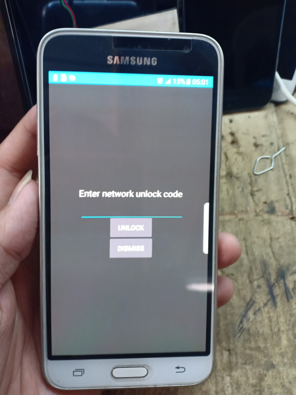

Magandang araw po uli mga katahanan. Nais ko lang ishare itong inunlock ko Samsung Amp Prime (J320AZ UD) Carrier Cricket.
Issue nilagyan daw ng sim pero naghahanap ng code
so ayun sabi ko kailangan po i openline yan so ayun pinapa unlock na niya at ako'y tuwang tuwa na dahil pera na naman haha.

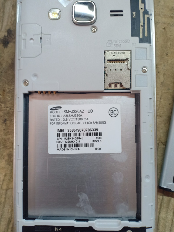

Unit:J320AZ

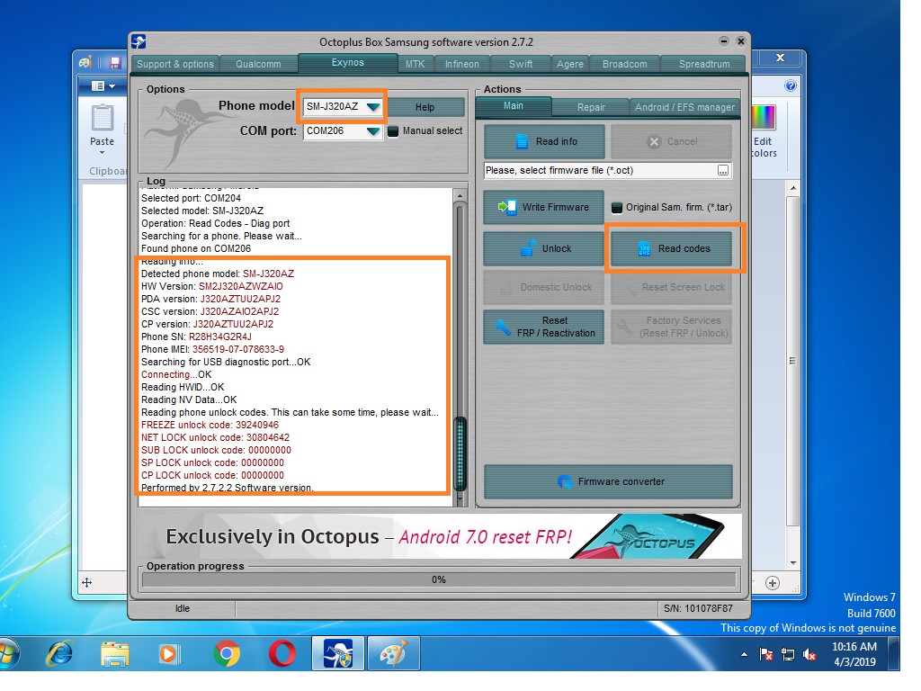

Octopus or Z3X box
1st. Select model 'J320AZ'
2nd.Click 'Read code' pop up appear click 'via Diag mode'
3rd.hitayin matapos.
Sundan nasa image

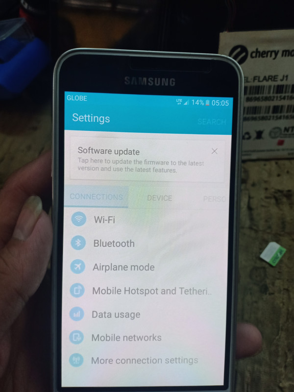

And heto na my finish product
