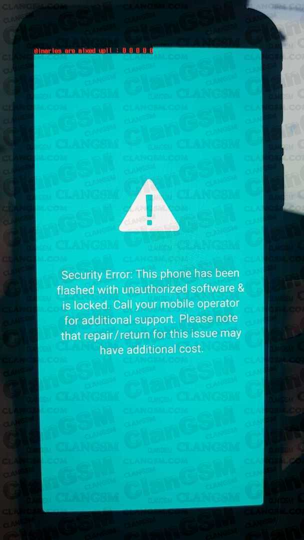

History:
nag Flash ako Nito
COMBINATION_FAC_FA81_J415FXXU2ASC2
After Combi flash
nag Flash nito sa z3x Complete Lahat
J415FXXU2ASC2+8.1.0+B2+2019.03.11+Factory
J415FXXU2ASC2_OJM2ASC2
J415FXXU2ASC1_OLM2ASC1
J415FXXU2BSDM_OLM2BSDM
Result into
Kaya na isip ko try sa Odin_v3.13.1
With this Firmware
Done
Binary are Mixed Up
Proceed to FRP 9.0
Power off screen
insert sim tray
reject tray and quick power button press
press lock
notification setting
see all
quickest
frpfile.com/bypass
download google account manager8.apk and install
download bypassfrp-1.0 apk and install
log in kana ng google alam muna yan
restart and Factory Reset
done
