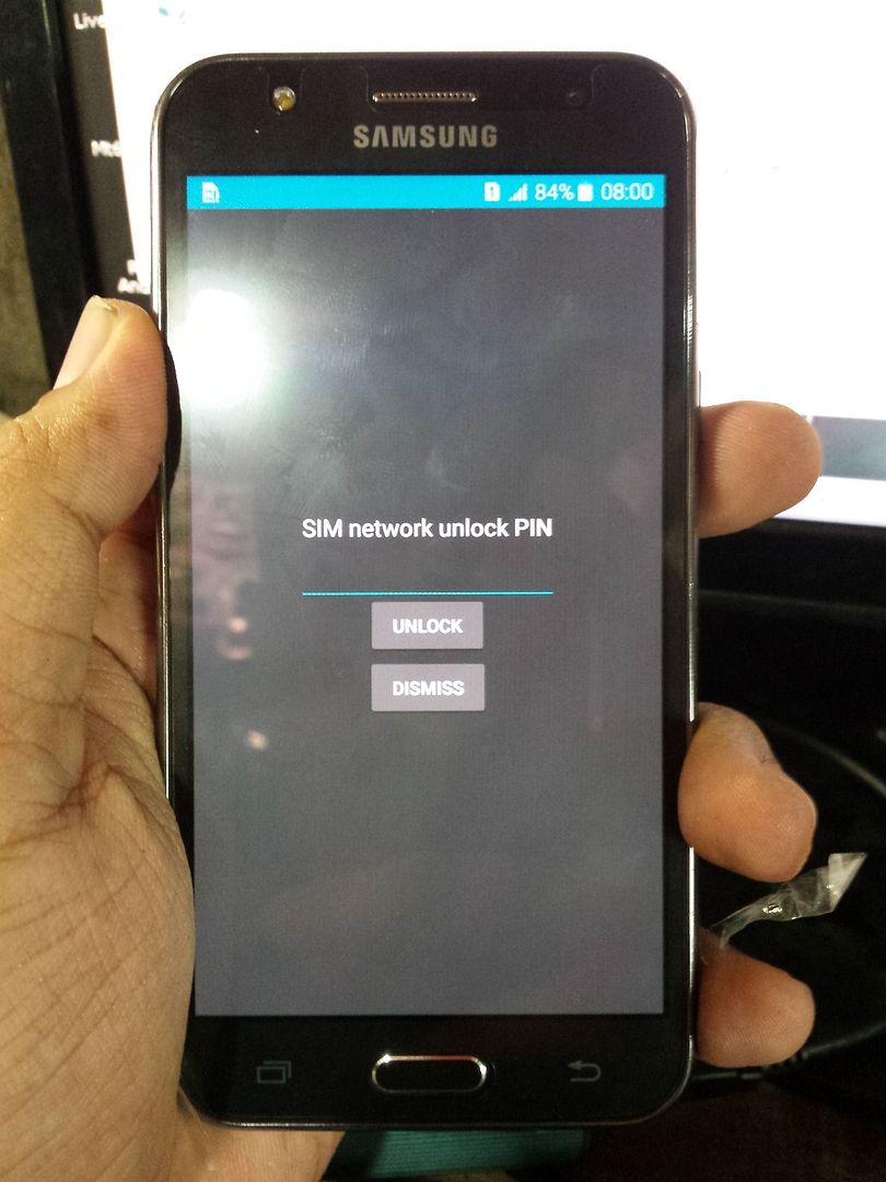

Ito po ang Unit ng dinala sakin naka network lock siya

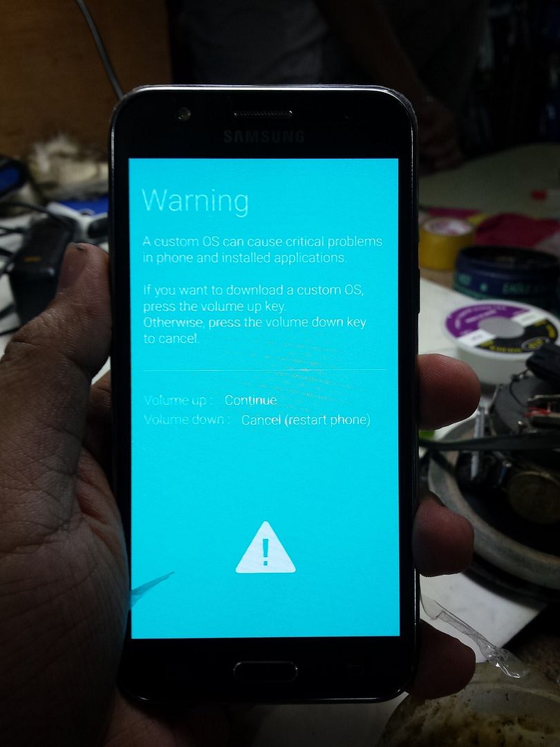

Put your phone on download mode , volume down + home + power

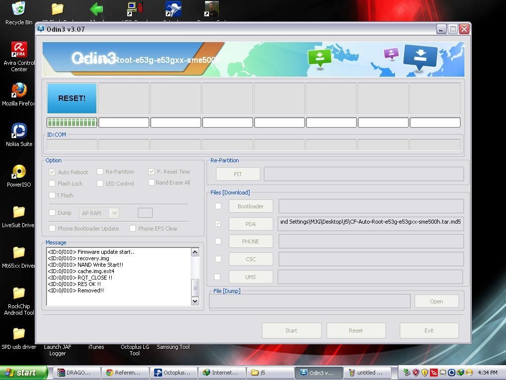

then extract niyo na yung attached file ko, open niyo ung Odin dun tapos set niyo sa PDA ang root file, saksak na ang phone sa pc, then tick start, wait lang hanggang magreboot ang phone

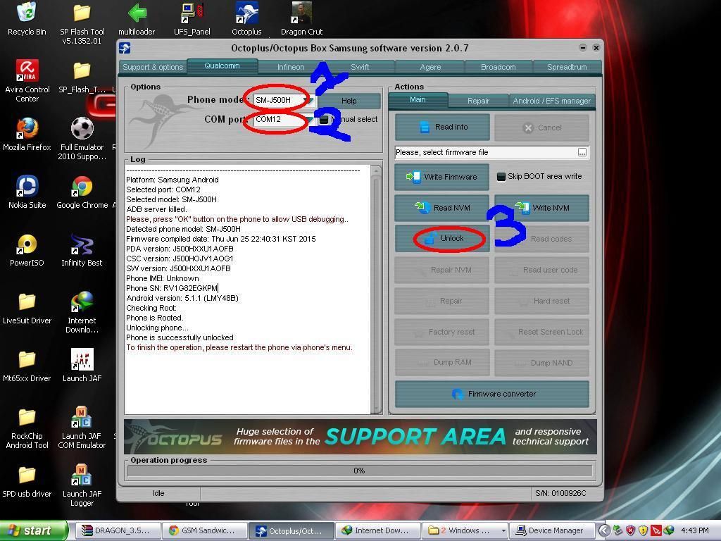

kapag rooted na open na ng octopus samsung tool, set niyo ang model sm-j500h, then ung COM niya set niyo din, enable niyo usb debugging sa phone, then tick Unlock, wait niyo nalang matapos ang Process

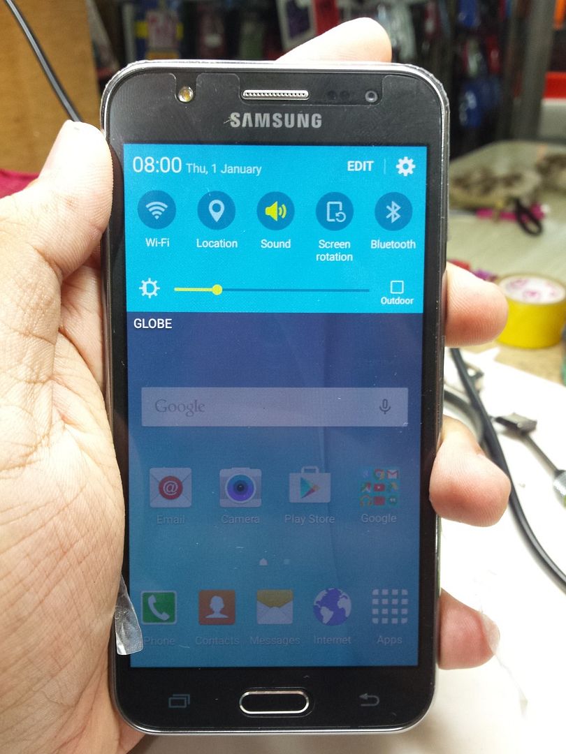

at BOOM ALAKDAN NA :D :D :D :D :D
Platform: Samsung Android
Selected port: COM12
Selected model: SM-J500H
ADB server killed.
Please, press "OK" button on the phone to allow USB debugging..
Detected phone model: SM-J500H
Firmware compiled date: Thu Jun 25 22:40:31 KST 2015
PDA version: J500HXXU1AOFB
CSC version: J500HOJV1AOG1
SW version: J500HXXU1AOFB
Phone IMEI: Unknown
Phone SN: RV1G82EGKPM
Android version: 5.1.1 (LMY48B)
Checking Root:
Phone is Rooted.
Unlocking phone...
Phone is successfully unlocked
To finish the operation, please restart the phone via phone's menu.
