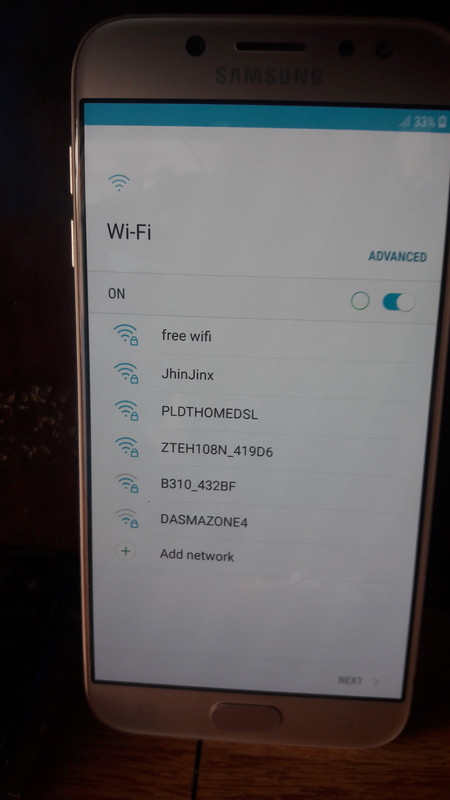

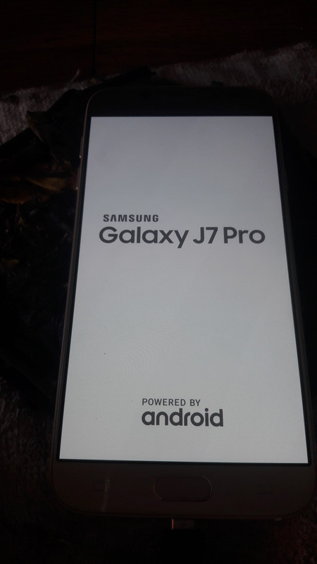

samsung j7 pro hang on logo done using
by odin
d2 ko kumuha ng firmware nia
link,,,,
https://updato.com/firmware-archive-select-model?record=295DD342DFFB11E89F15FA163EE8F90B
ung odin version n ginamit ko
odin 3.12
cencia n mga bo d ko nakuhanan ung odin
take note after flashing yan pag hang p rin hardreset
nio lng done n yan
sana makatulong hit tnx n lng
my frp p yan d ko n gnawa kc alm nmn dw ng may ari ung gmail account
