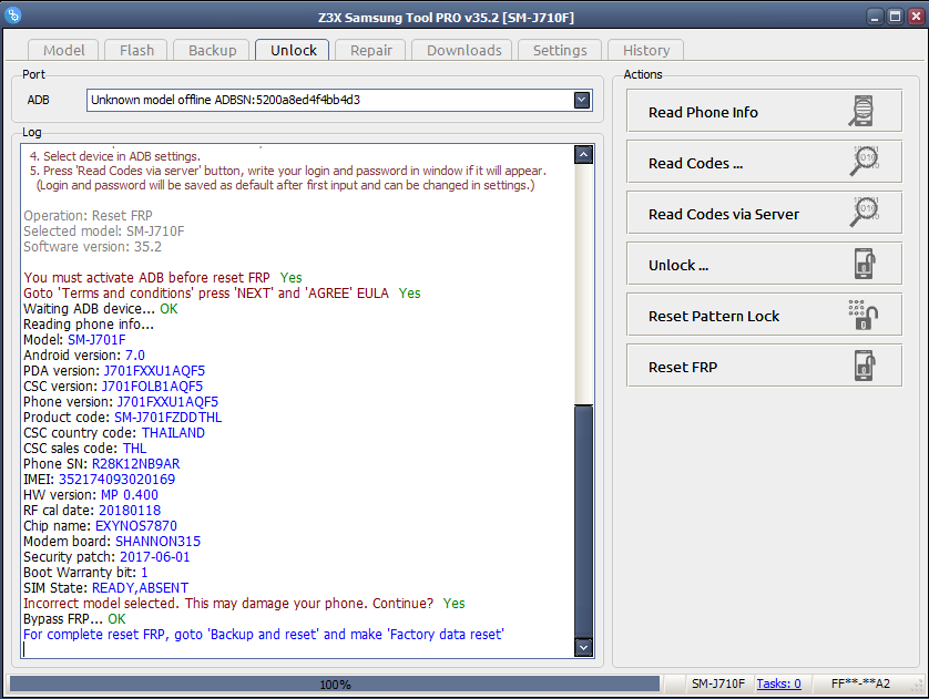

FRP binary block
Procedure
Flash
Flash with z3x support
J701FXXU1AQF5_OLB1AQF5
Proceed to FRP

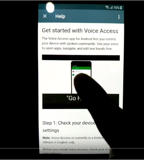

Hindi maka Access sa
Kaya ito Solution ko
HUSHSMS APK
https://mega.nz/#!OugHWQ6R!zhDC0H9loYA4EjOn8DGw28KMLN9_rTj42a9uqU7BcKs
or
https://www.mediafire.com/file/zh3hr5z3lwvd19j/HushSMS_2_7_7.apk/file
https://www.youtube.com/watch?v=pwwsbuwZayA
Pasok kana sa youtube
https://www.youtube.com/watch?v=Ig3i97M2gIo
Download FRP_android_7
(+30012012732+
delete +
press+ to launch DRparser mode
dial *#0808#
(USB/AP) DM+ACM+ADB then Reboot
Now ADB ENABLE na
Pwede na Tirahin sa Z3X for FRP see Picture
Factory Reset For Better Result
Done
