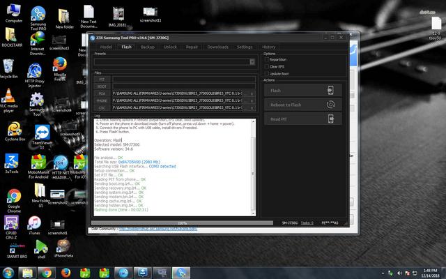

pde gamitin ang odin or z3x to flash combi after flash

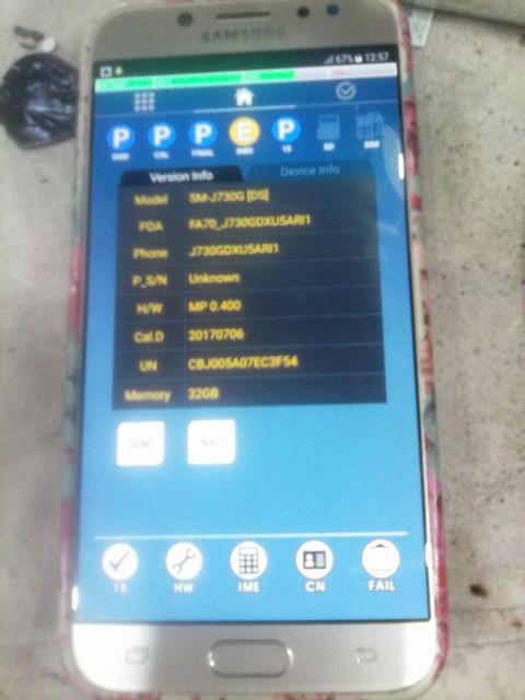

ang Magiging State ng CP is Binary Blocked By FRP
Parang Magiging Test Mode Xa like this sa PIc

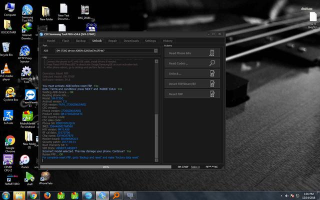

ngayun pwede na xa remove FRP
kasi Open na ADB nya
After maremove FRP flash Stock Rom using Z3x uncheck sa AP ung Userdata click ung 3 dots para ma uncheck
Done Na ang FRP

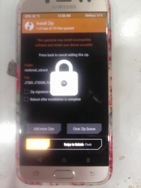

Fix Touch Not Working
Use OTG Mouse to set UP
punta sa Settings/About Phone/Software Information
Click Build Number 7x para Lumabas Ang Developers Option
At I On ang OEM unlock at Usb Debug

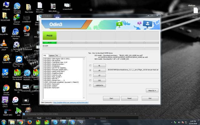

Restart Phone to download mode At Flash Twrp
using Odin Uncheck auto Reboot
Magmanual reboot para TWRP na recovery
Reboot Manual at dapat Twrp na recovery nya

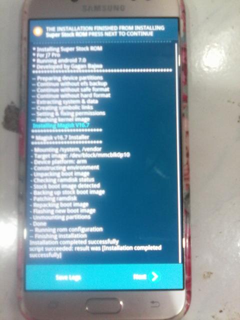

Ilagay sa Memory Card ang Pang Touchfix na Zip
Tapos install zip na Pang Fix Touch
Hintayin lang mag done
After install

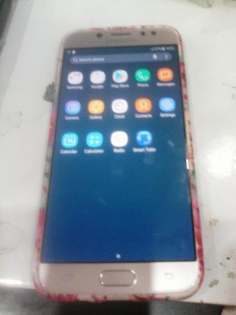

do a Hard Reset and Your Done
DONE
