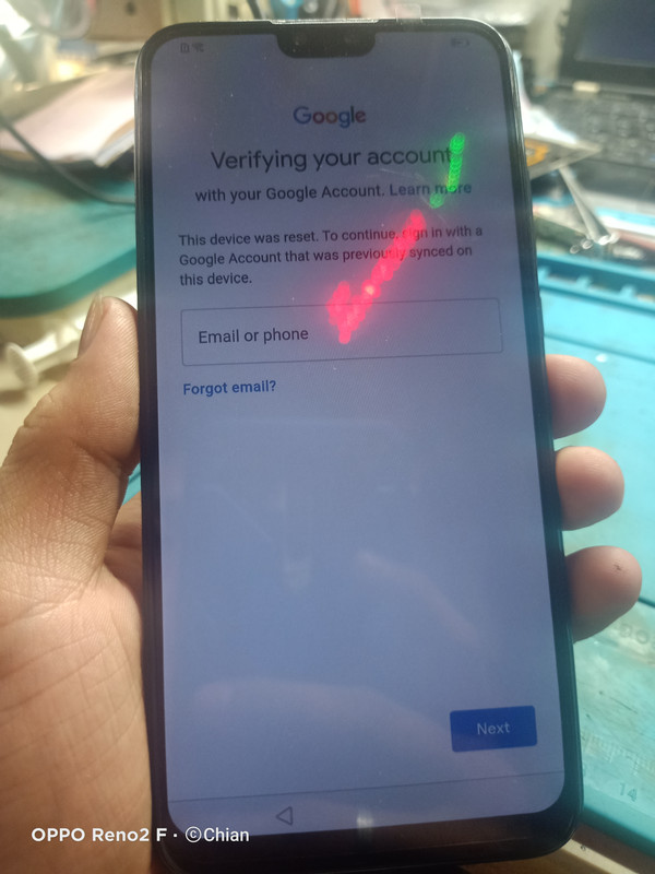

Good day po sa inyong lahat. Today may narecieve po akong unit jkm-lx2 frp problem

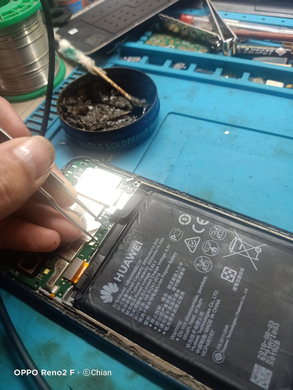

Now process po tayon. Baklas unit and make test point

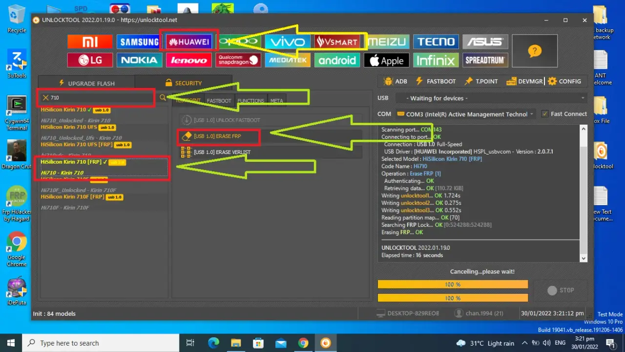

Now open unlocktool, click 'HUAWEI' tab and search '710' next click 'HiSilicon Kirin 710 [FRP], next click '[USB 1.0] ERASE FRP' and wait hanggang matapos.

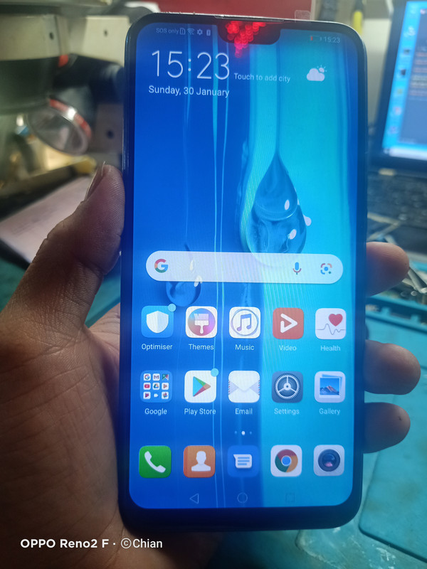

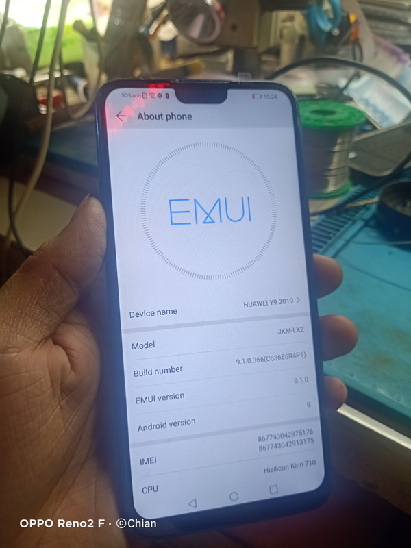

At heto naman po resulta ng aking process.
