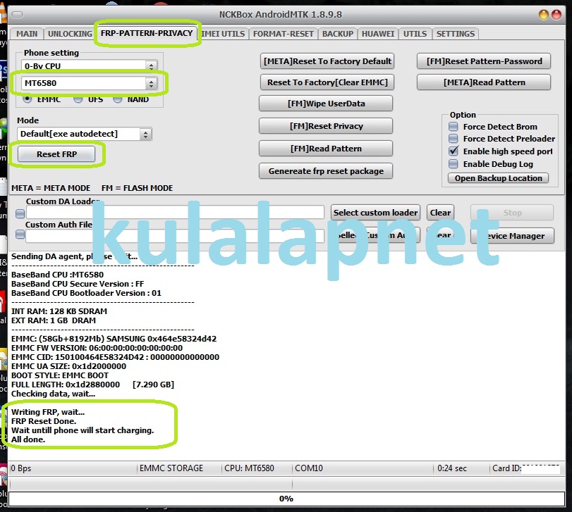

Kata L1 frp done in NckBox
/open nck mtk module
/goto FRP-Pattern-Privacy tab
/select MT6580 cpu
/click Reset FRP
/insert cable to phone
/voila
Read Info:::
Action : Boot Info.
Selected 0-By CPU:MT6580
Exe version: NCKBox AndroidMTK 1.8.9.8
Reinsert phone battery.
Battery must be charged.
Phone must be off with battery inside.
Please insert USB cable now...
Detected : PreLoader USB VCOM Port (COM10)
Boot mode: Preloader
BBCHIP: 6580 0 ca00
Using Algo 1.
Phone detected...Please wait
Sending DA agent, please wait...
BaseBand CPU :MT6580
BaseBand CPU Secure Version : FF
BaseBand CPU Bootloader Version : 01
INT RAM: 128 KB SDRAM
EXT RAM: 1 GB DRAM
EMMC: (58Gb+8192Mb) SAMSUNG 0x464e58324d42
EMMC FW VERSION: 06:00:00:00:00:00:00:00
EMMC CID: 150100464E58324D42 : 00000000000000
EMMC UA SIZE: 0x1d2000000
BOOT STYLE: EMMC BOOT
FULL LENGTH: 0x1d2880000 [7.290 GB]
Status: USB_HIGH_SPEED
Detecting high speed port, wait......
If driver not installed, install high speed port driver.
If not need high speed port, disable it.
After repeat opperation.
Detected : MediaTek DA USB VCOM (Android) (COM11)

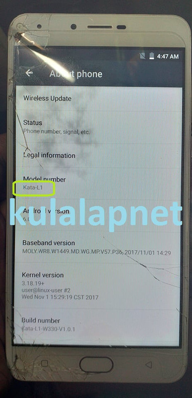

Build ID: MRA58K
Display ID: Kata-L1-W330-V1.0.1
Version: 6.0
Build Date: Wed Nov 1 14:37:10 CST 2017
Build Date: 20171101
Build Date: 1509518230
Model: Kata-L1
Brand: Kata
Device: L1
Manufacturer: Kata
Mediatek Version Release: alps-mp-m0.mp1-V2.34_vz6580.weg.i.m_P148
FRP partition: /dev/block/platform/mtk-msdc.0/11120000.msdc0/by-name/frp
This phone have FRP partition.
IMEI[1]: 758113400432692
IMEI[2]: 013584973126204
Read done.
Wait untill phone will start charging.
All done.

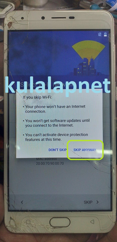

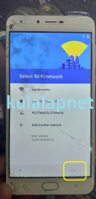

=walang skip kasi may google account pa=
pagtanggal ng google account
ayan may skip na
done na
