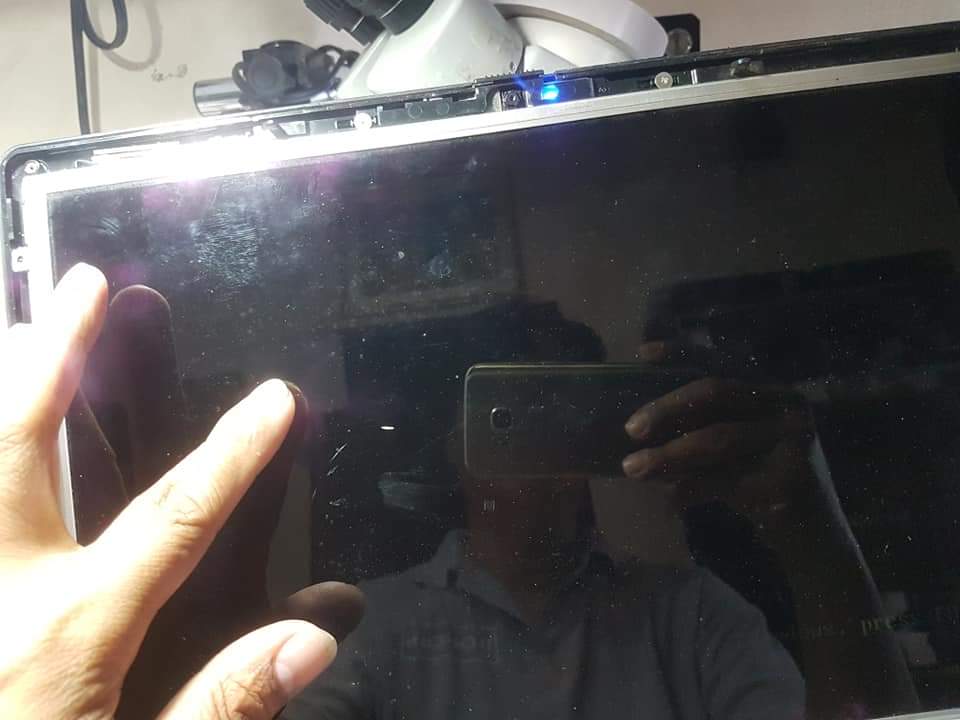

Issue: Wala ilaw sa LCD

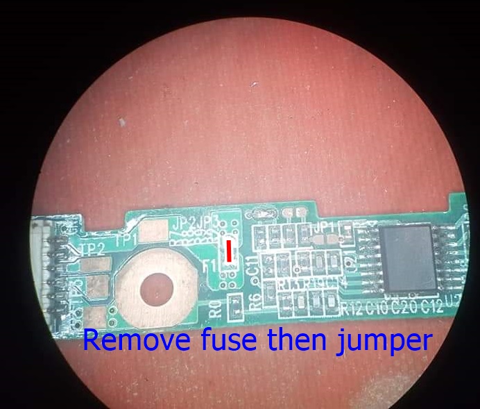

Action taken:
Palit LCD, no luck
Baka inverter, pero wala ako available na inverter. Kaya check ko inverter nya.
Check fuse, ayun open. Jumper ko then test. Kaso ayaw mag power.
Test ko fuse with respect to ground, ayun meron shortage pala.. Kaya ayaw mag power dahil meron short.
Action taken ulit:
Visual check ko parts ng inverter, nakita ko capacitor na corroded. Tinanggal ko.. Nwala ang short.

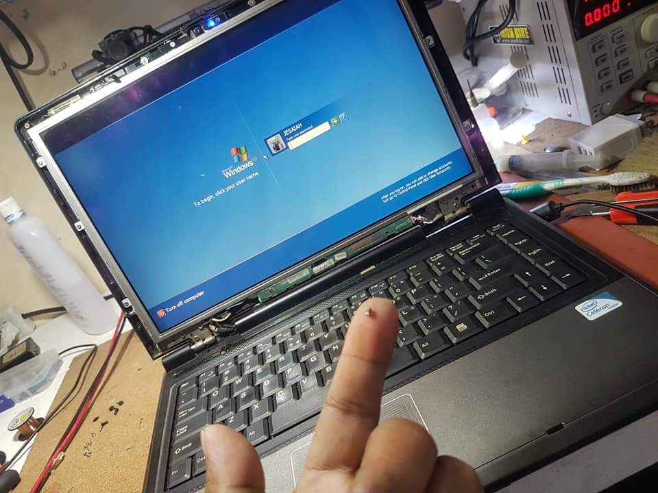

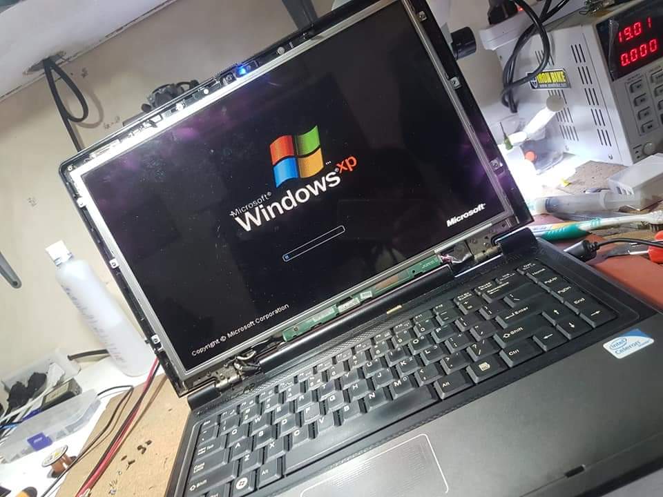

Testing ko, ayun ok na..
OLD But GOLD
