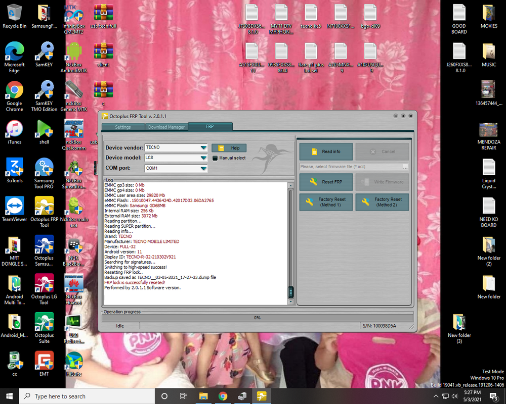

sorry po wala akong pics ng actual phone,pasa lang ng co-tech di ko akalaing magagawa pala
hiOS welcome image
OPEN OCTOPUS FRP TOOL
TECNO
SELECTED MODEL LC8
FACTORY RESET METHOD 2 (to avoid failed or error on reseting frp)
POWER ON PHONE (WAIT 3-5 MINUTES)
POWER OFF PHONE
RESET FRP
POWER ON PHONE
SETUP THEN SKIP
DONE
sundan mo lang po yan matatanggal mo frp niyan
dami kong trial na ginawa failed kala ko di pa supported ng octopus
sana makatulong..
