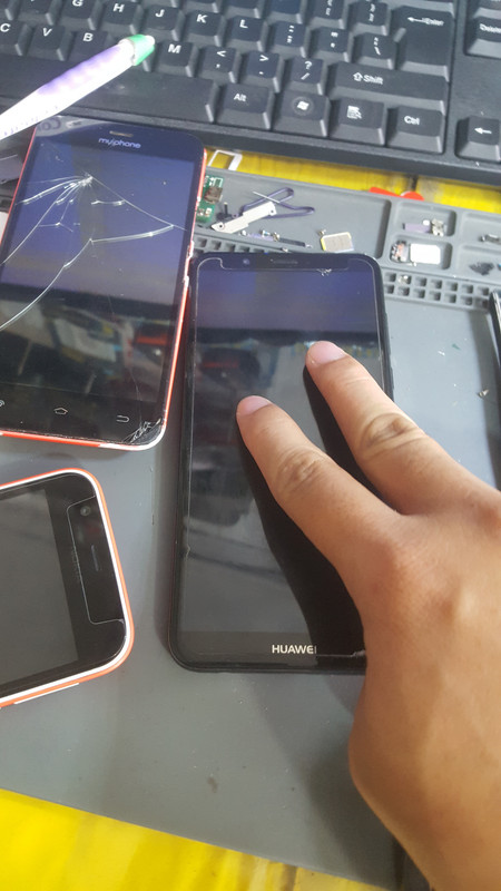

1st. Google account problem
connect to wifi.
Hold ng 2 fingers yung
Di ko po napictureran yung pag talk back
pero ganyan po gagawin nyo sa first step
2nd. Draw letter L
( click talkback setting)
(click Help and feedback)
(click get started wit voice access)
(click share button then youtube )
Pag nasa youtube na kayo click nyo yung share button
then may list na lalabas don
click nyo yung gmail.
add kayo ng account
(Make sure na may outlook or hotmail account kayo)
once po naka log in na kayo
hit nyo yung take to gmail.
Watch nyo po yung video
3rd. Pag nasa settings napo kayo
hanapin nyo po yung reset.
Reset setting nyo po ng 3times
tapos pag na reset nyo na
mag add kayo ng pattern
pag nakapag add napo kayo ng pattern
Restart nyo napo yung phone
Sana po makatulong kahit magulo hehe
