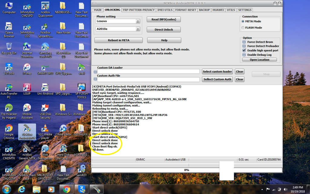

shrare ko lng po baka sakali makatulong sa newbie gaya ko lenevo A2010a lock sa globe
TOOLS;
loptop or pc
nckbox
micro usbcable
PROCEDURE:
1;open nckbox
2;go to andriodmtk tab,click unlock
3select excact model unit power off the phone
4;click read info (codes) or (direct unlock) kng ayaw ung tangaping ang codes
5;then insert usb..wait until finished...
ACTION TAKEN;

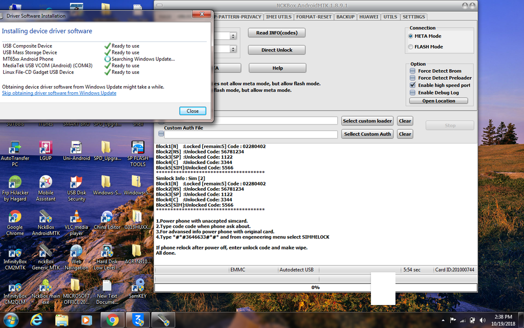

try ko muna readcode true usdcable para safe kng sakali..
succsess naman sa readcode kaso ayaw na tangapin ng phone ang codes
kaya no choices direct unlock kuna
AYUS... thnx 4 viewing...
