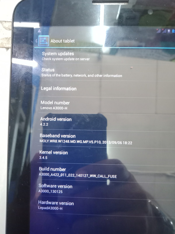

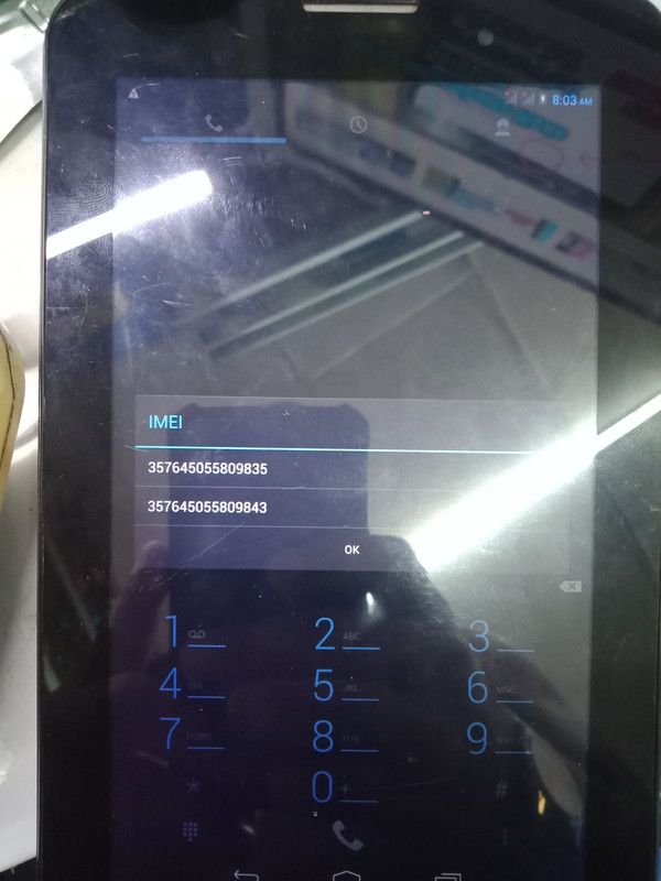

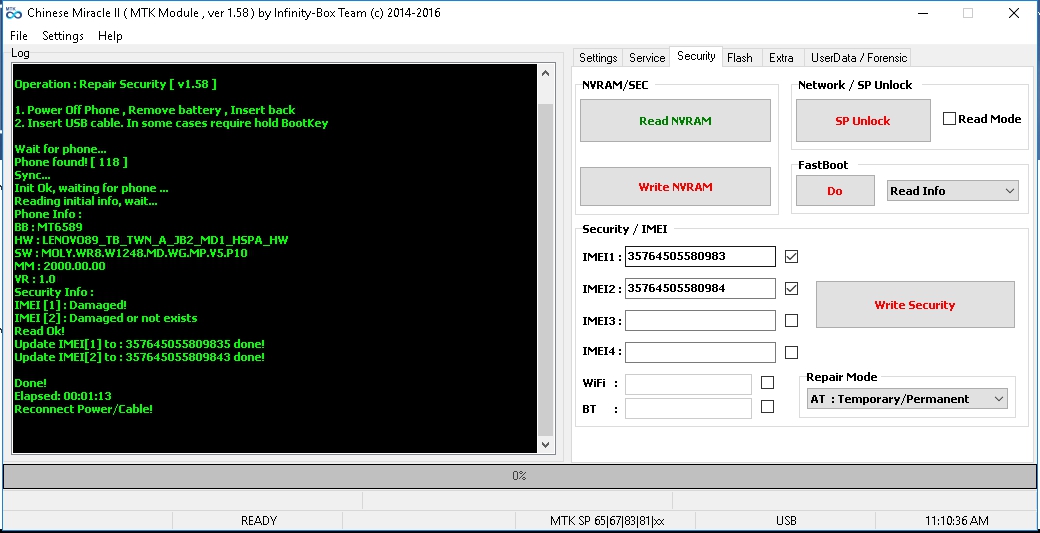

andreivi Expired Account Joined Jul 30, 2014 Messages 1,986 Reaction score 271 Points 381 Location Sison, Pangasinan/ Rosario, La Union Dec 11, 2019 #1 share lang for reference Lenovo A3000h invalid imei done sa CM2 open CM2MTK select correct platform click security tab input imei click write security insert usb to unit (turned off) done
