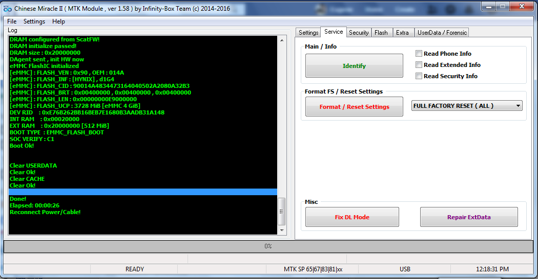

share ko lang po itong gawa ko Lenovo A319 S318 150615 hang sa logo kc may virus
una backup muna para safe..
flashing na..
open cm2mtk set muna natin settings emmc
wala nang paliguy ligoy pa flash na load FW at tick flash
wait hang matapos done..
open muna phone
mejo matagal ang booting wag mainip..
eto pala FW ko ginamit http://www.mediafire.com/file/f37xuxqbfd3zn5n/A319_ROW_DS_S318_150615.7z
flashing na..
open muna phone
