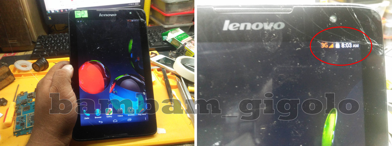

pinagawa/repair sa aking kasi di makadetect ng sim at nairepair ko naman but sadly
after 2 days bumalik at sira na naman yun sim slot nanirepair ko dahil sa pagkabit/kalas
ng mga triple cut na sim (using microsim)so in-advice at sinabi sa tomer na since under warranty pa naman yun nirepair ko,libre na yun labor to repair pero mas maganda kung palitan na pinaka buong sim slot para hindi na prone masira sa kakapalit ng sim..kaso hindi na sya maging click-insert slot kundi normal micro sim slot nalang for an additional price para sa pyesa..
PROCEDURE: (FOLLOW SCREENSHOTS)

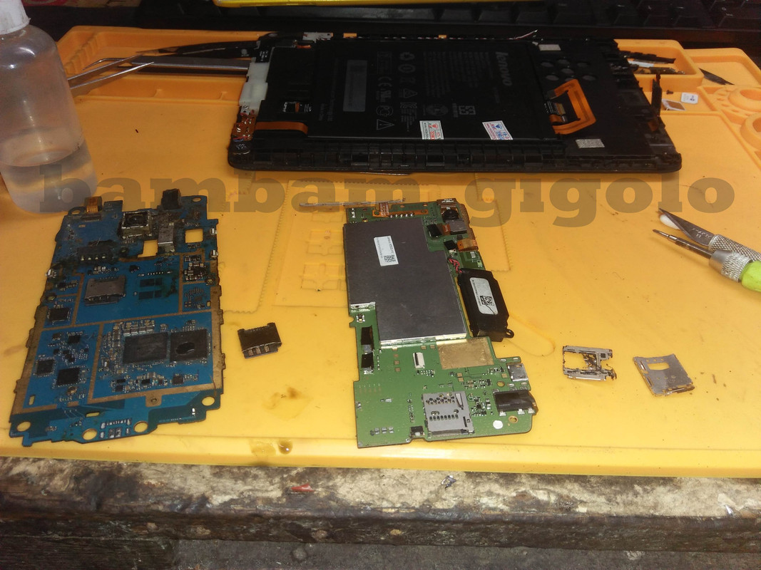

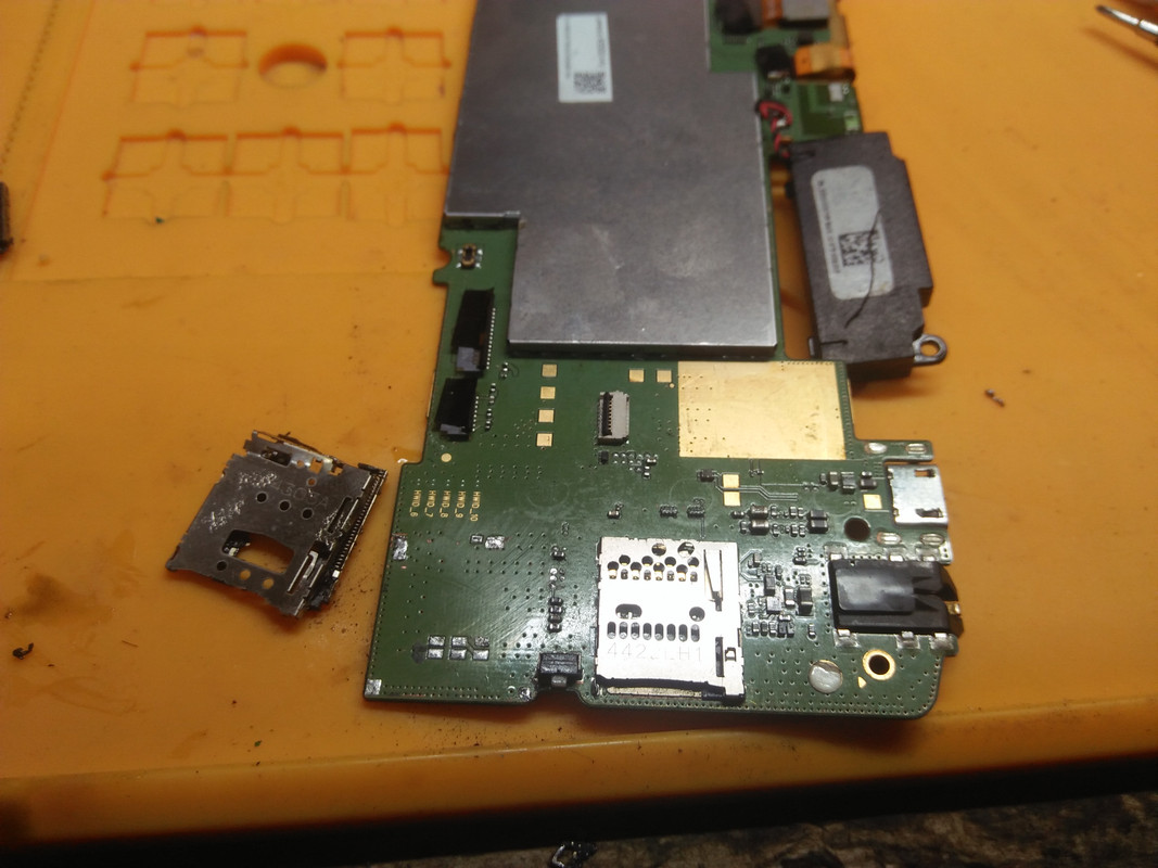

-disassemble unit and remove old/broken sim slot

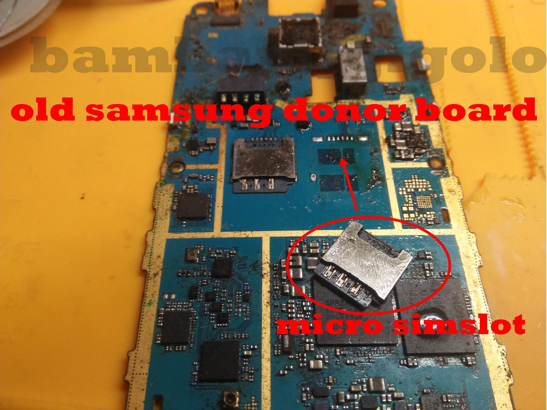

-get a manual(non click type)micro sim slot from any donor board

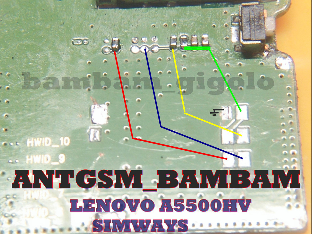

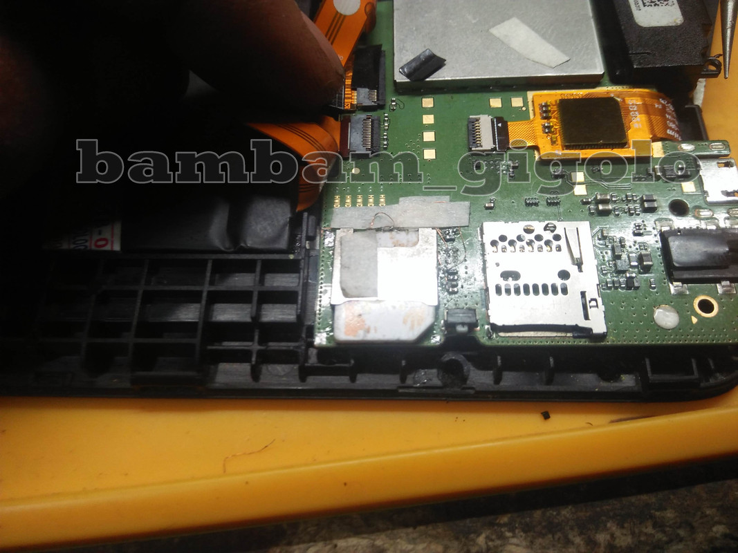

-allign simslot and make proper jumpers and insulate(see pic of simways)
-test the unit then reassemble.. done!!
-THANKS FOR VIEWING,FOR REFERENCE ONLY
