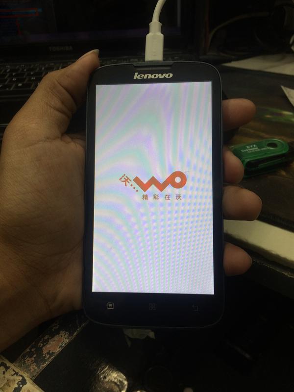

===>Lenovo A560 logo Pagdating sakin kaya hanap ako firmware!

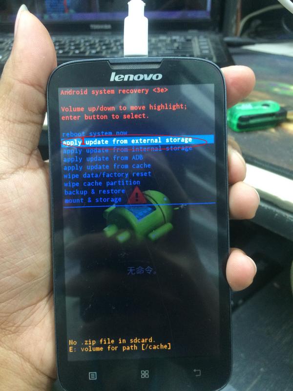

===>Press volume Up+Power button
===>Recovery mode

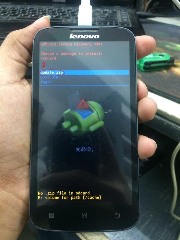

===>Apply update from external storage
===>Update zip

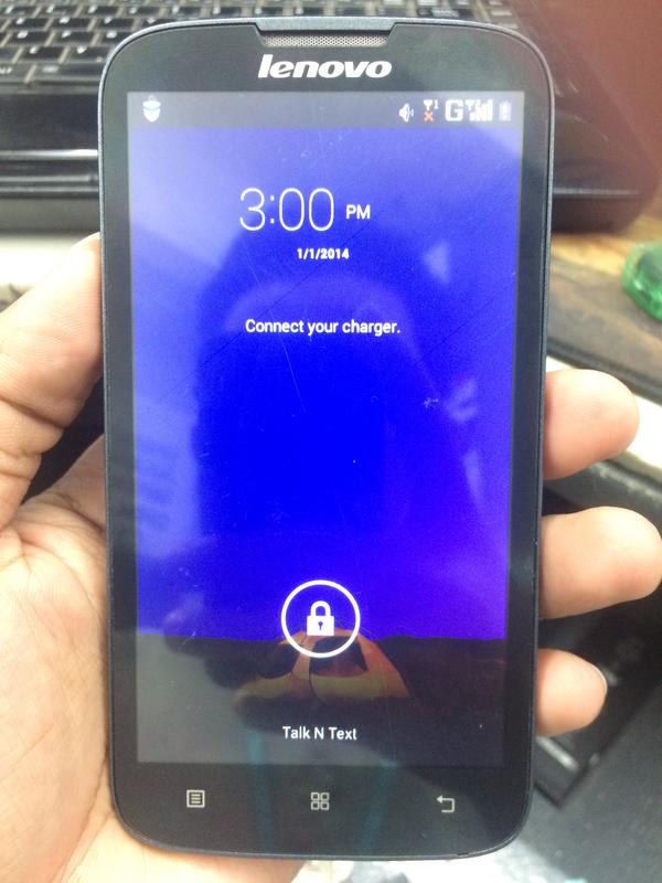

===>Hito na Finish Product:)
