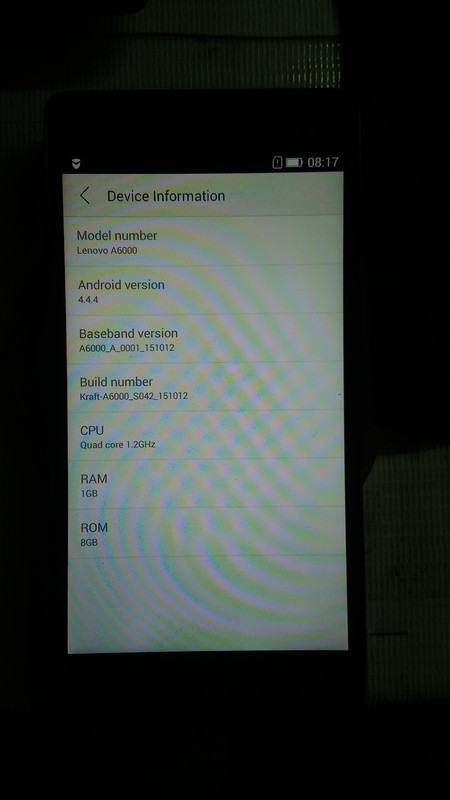

history ng update at namatay ang cp pg on recovery nalang
share ko lang mga boss itong tanggap ko
Stock lng sa recovery at kung minsan hang sa logo
24 petrol station near me

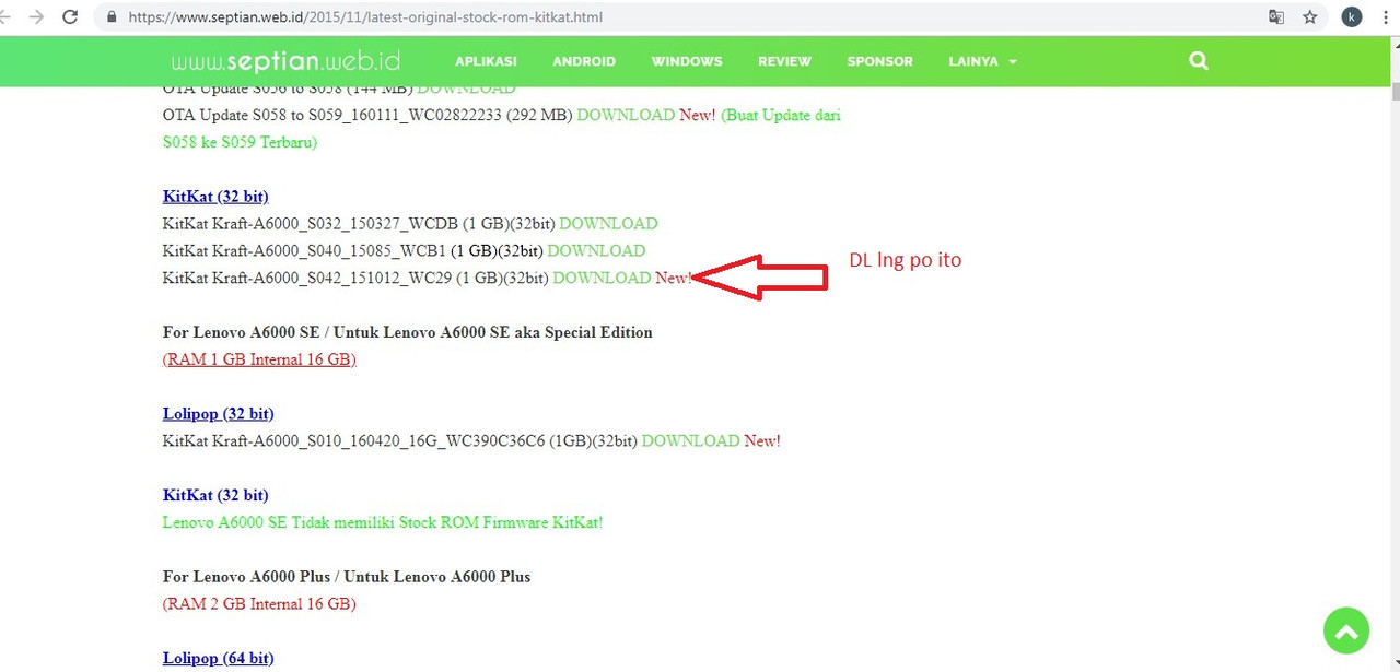

una idownload ang firmware dito
https://www.septian.web.id/2015/11/latest-original-stock-rom-kitkat.html

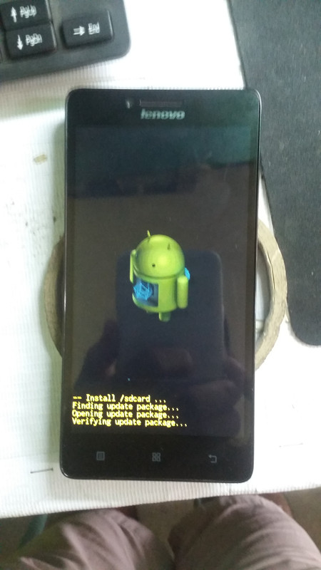

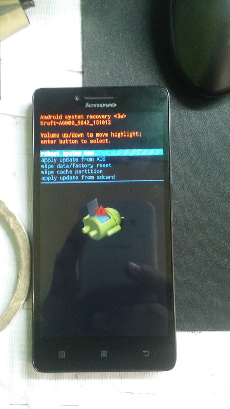

ilagay ang files na naka rar sa memory pressing volume up, down at power para sa recovery mod nia
at select install update
where is the nearest shell gas station
at hintayin lang po hanggang matapos
nearest keybank

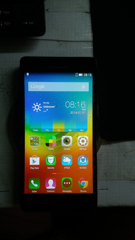

Done
