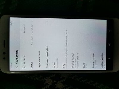

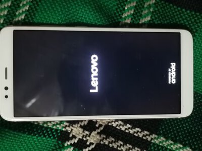

DOWNLOAD lenovo k520/s5 hang on logo tested firmware/frp done kay hydra tool

history hang on logo

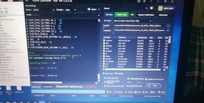

open hydratool qualcomm
select flash tool
select manual select raw/patch xml
load firmware
boot key hold volume up/down
para lumabas qualcomm drivers
wait mo matapos...tested yan

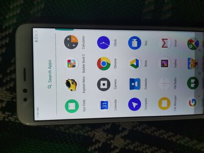

may frp po siya

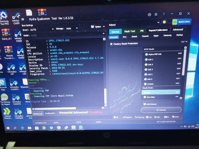

ginamit ko si hydra
select auto lng po
boot info
factory reset protection
auto
execute
wait matapos...eto po proof
