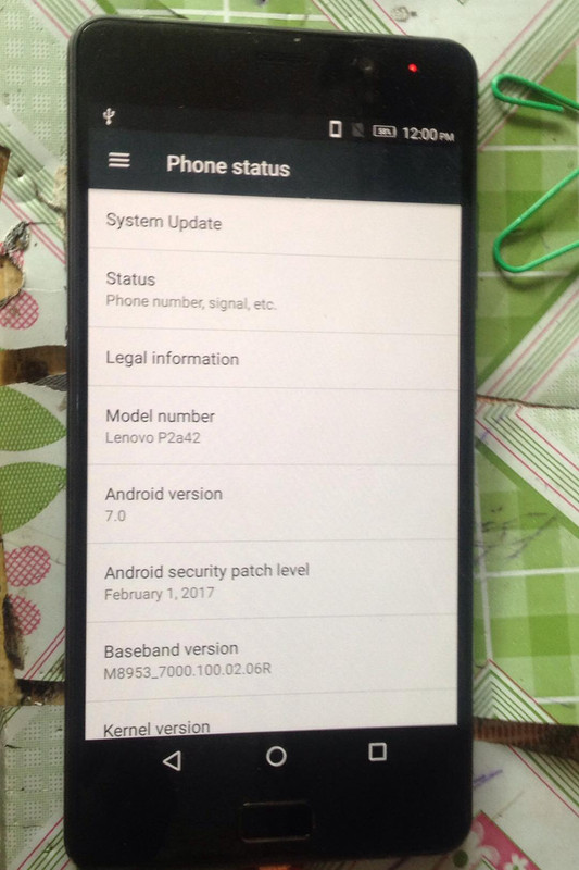

LENOVO P2A42 HANG DONE
share ko lang po mga kaant
dagdag reference po sa ating mahal na tahanan
share ko lang po

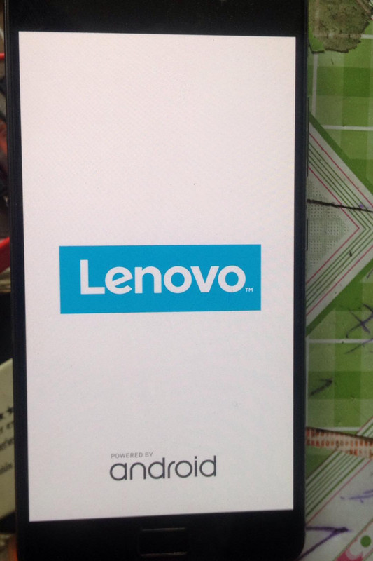

history .ina update then nalowbat ayun tulala
first hanap muna firmware dito sa tahanan but no luck di gumana firm
di siguro compatible version
hanap naman kay google ayun may nakita
eto http://www.mediafire.com/file/no35yqbt5ssj5b2/Lenovo_P2a42_S233_20170404.zip
procedure

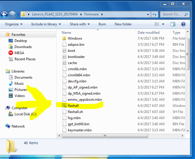

extract muna nadownload na firmware
open folder
then click nio po yung nakahighlight sa pic
lalabas po yung parang cmd

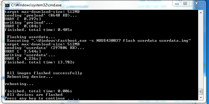

then boot po yung phone sa fastboot mode
by using volume down and power
then connect sa pc wait mag install driver then mag run na yan
wait until finish

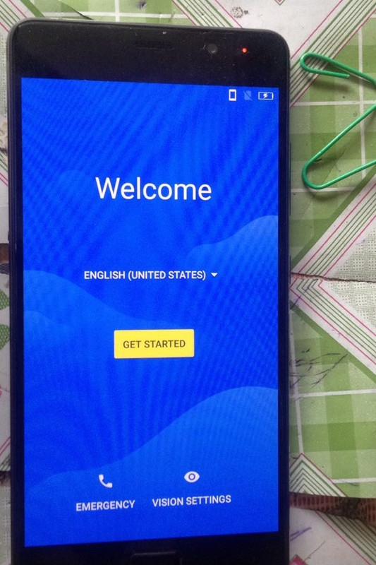

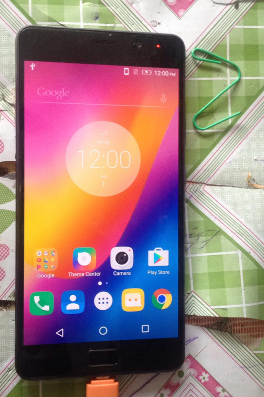

after flashing eto na
done na po
sana makatulong
hit thanks salamat po
