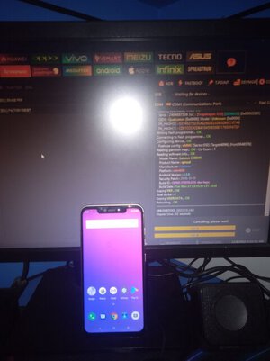

REFERENCE LENOVO S5 PRO HANG ON LOGO DONE VIA UNLOCK TOOL...

PROCEDURE:
OPEN UT
SELECT LENOVO TAB
SEARCH LENOVO S5 PRO
SELECT LENOVO S5 PRO GT
CLICK FACTORY RESET
PRESS VOL UP AND DOWN THEN SALPAK USB PAG DI NA DETECT IN TEN SECONDS BITAWAN ANG BOOTKEY MAGKUKUSA NA DETECT YAN THEN WAIT UNTIL FINISH..
DALANDONE..
