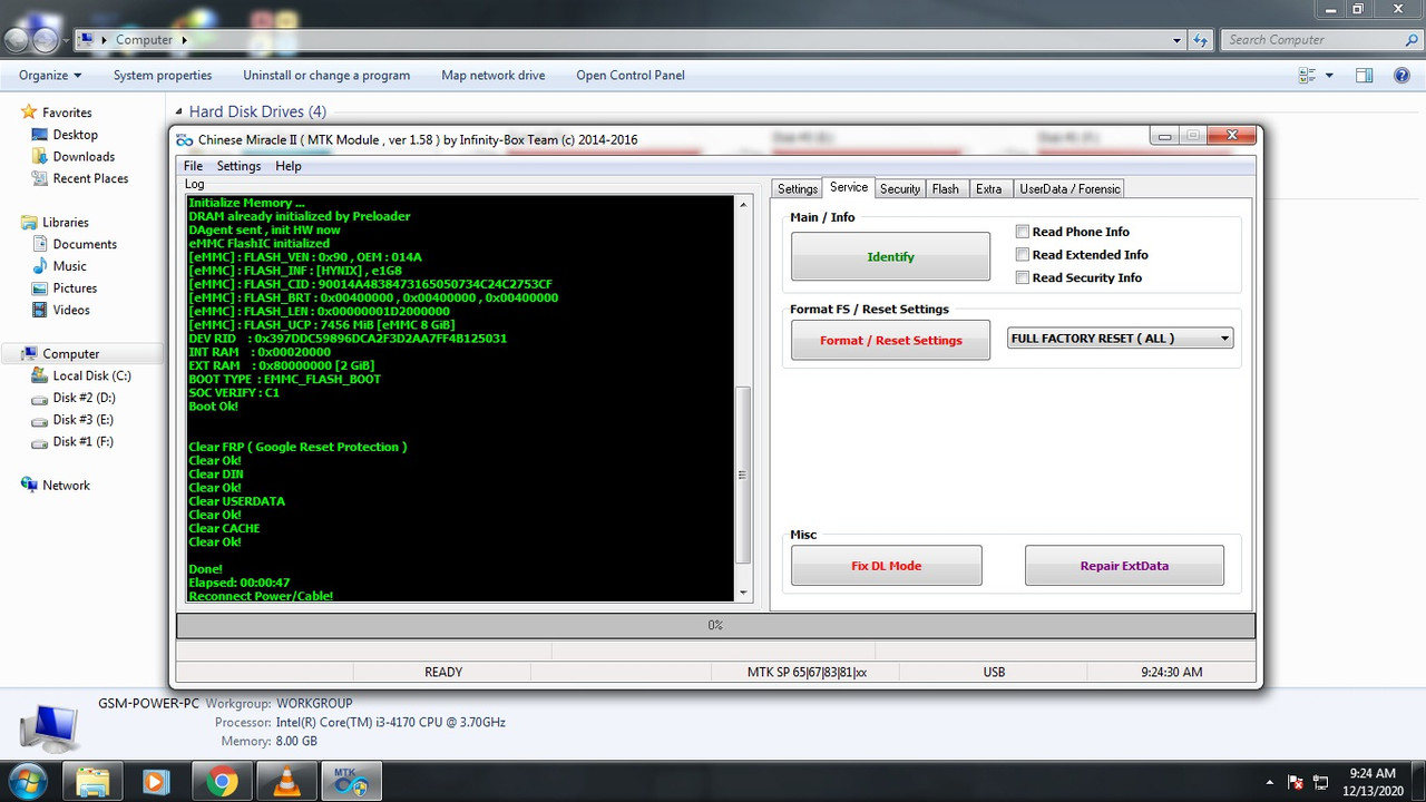

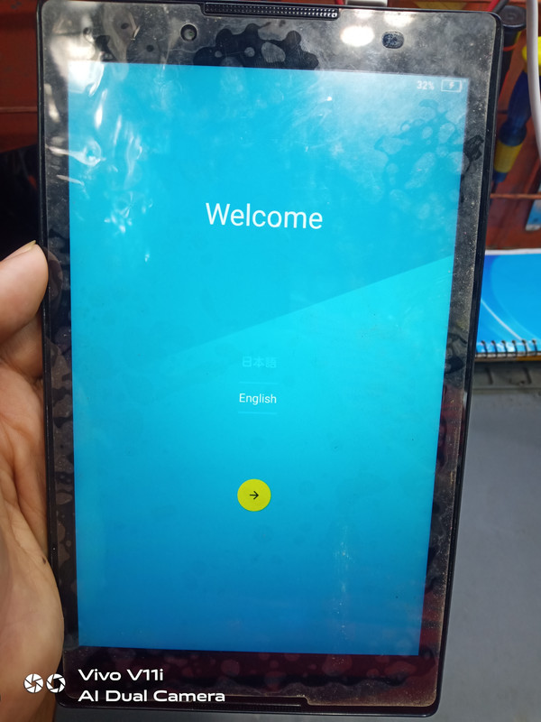

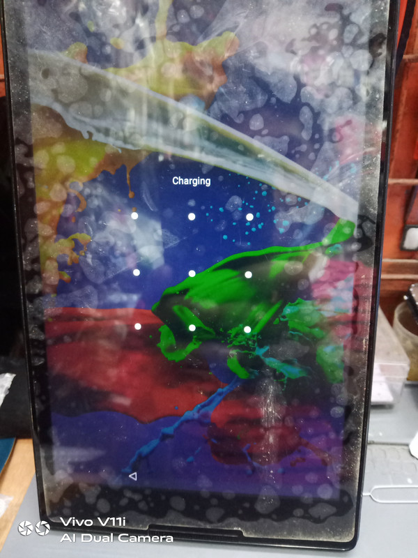

Share Ko Lang Mga Master Tangap Ko Kanina Status
Nakalimotan Ng Anak Ni Tumer Ang Pattern Na Nilagay Niya
Step. One
Open Nating Cm2 Off Ntn Unit Selec Format/Reset Settings Press Vol.+Up Salpak Usb
Step. Two

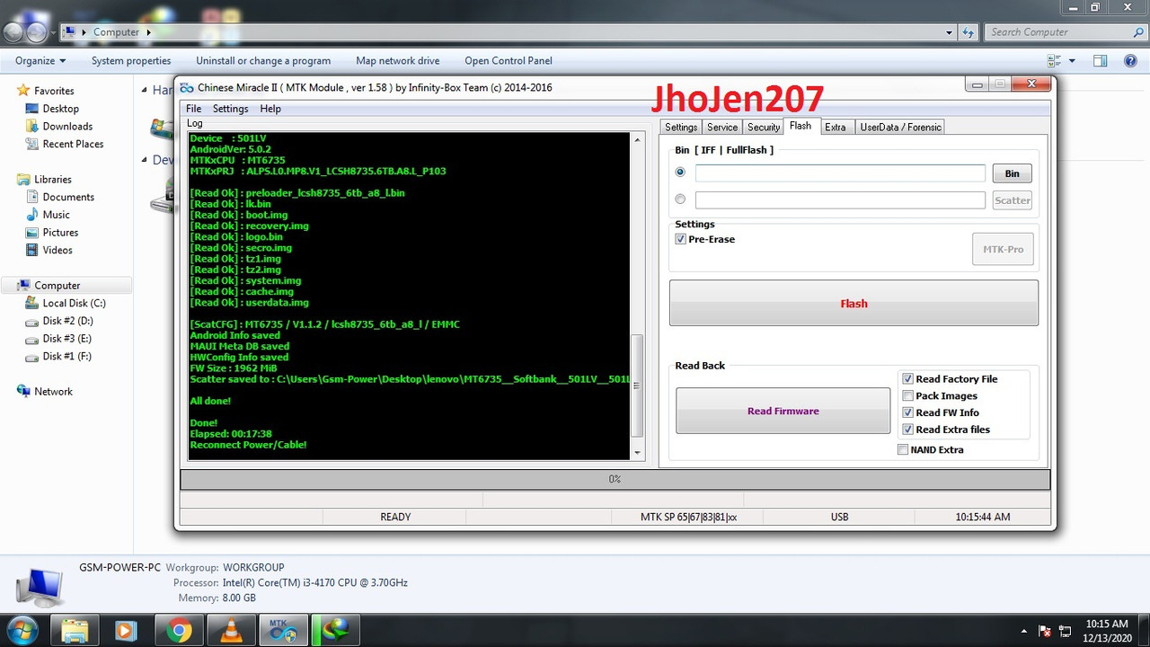

Naisip Ko BackUp Ko FW Niya Minsan Kasi May Naghahanap Ung Galing Sa Unit
Off Ntn Unit Again And Selec Read Firmware & Press Vol.+Up Salpak Usb

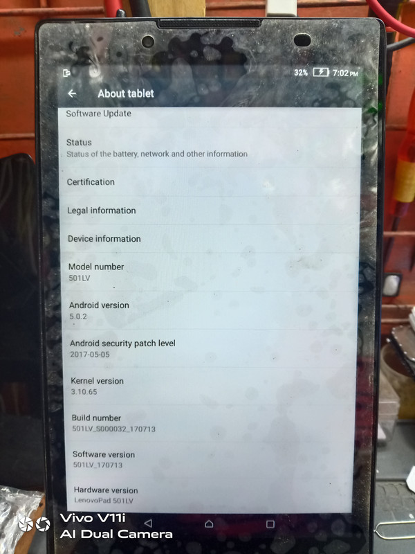

Created by Infinity-Box (c) Chinese Miracle II (c) 2016
Device Brand : Softbank
Device Model : 501LV
Device CPU : MT6735
Device IntName : Lenovo_TAB2_501LV
Device Version : 5.0.2
Device Compile : 7/13/2017 9:26:17 AM
Device Project : ALPS.L0.MP8.V1_LCSH8735.6TB.A8.L_P103
Device ExtInfo : 501LV
Download Here Firmware
Pass;JhoJen207
