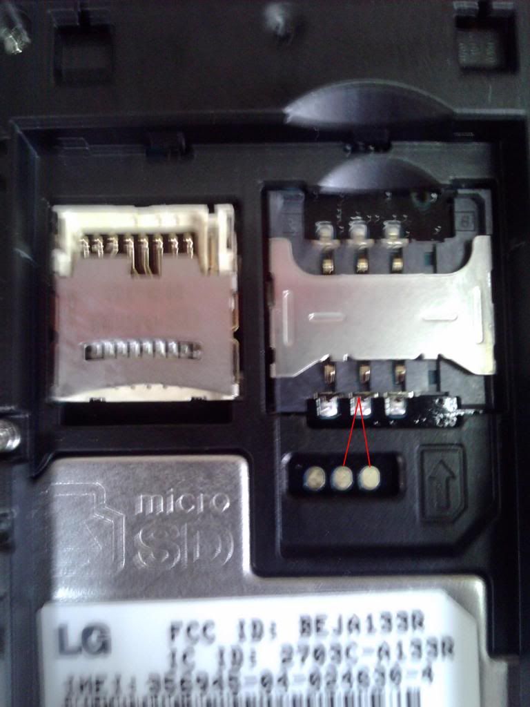

Procedure:
1. Open Octopus Tool select Infineon Tab
2:select phone model click usb mode click connect
3:disconnect battery form phone insert usb cable
then short Testpoint to ground see the image below..
4:click readcodes
5:then power on phone without sim card then dial 2945#*133#
6:enter nck code
7:unlock done
