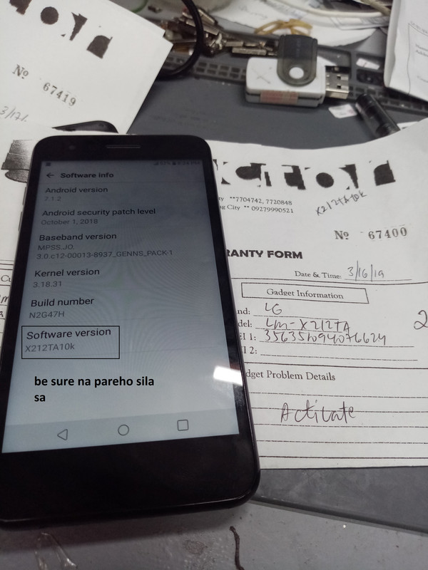

7.1.1 android version
check the softwre version very well at siguraduhin na pareho software version ang gagawin sa screenshot ko..

kaya sa may tanggap ng ganito be sure u have to check the firmware kung may available na dahil medyo mahirap mag hanap ng file...

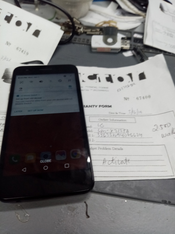

unit is from us and lock from metro pcs...(meron din t-mobile at iba pa...)
model;

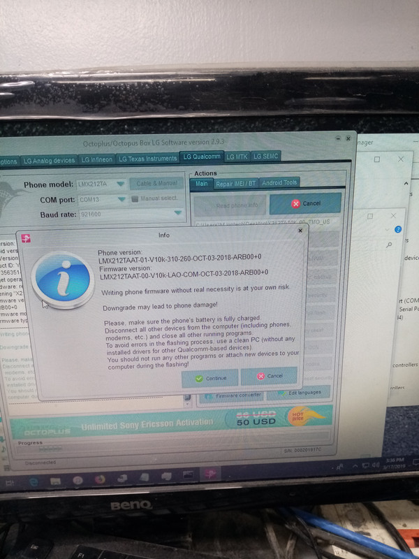

eto rin download nio flashfile kung sakaling di gumana yun patch boot image...flash in octoplus

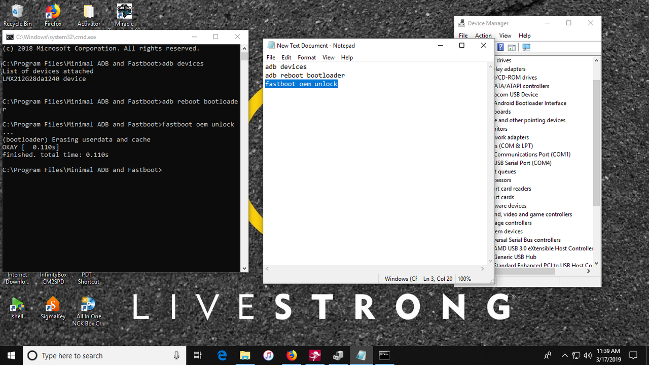

open mo si Minimal ADB and Fastboot at eto ang
command for unlocking bootloader
type this
adb devices
enter sa keyboard
type ulit this
adb reboot bootloader
enter

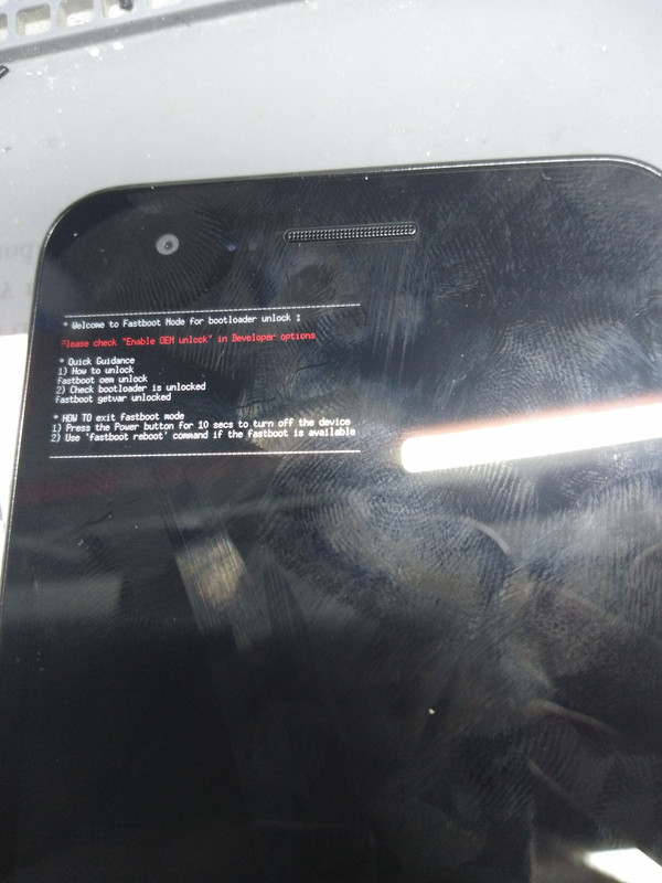

yan ang lalabas sa unit...
type ulit minimal adb
fastboot oem unlock (enter keyboard)
fastboot reboot (enter keyboard)
nearest open gas station
pagganito lumabas after reboot ng unit smile kana pero konte lang ha kc bootloader palang yan nagagawa

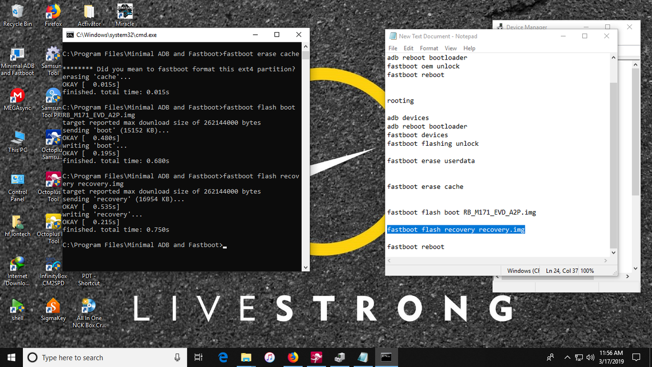

sa rar na dinaowload nio meron root file dun extract nio yun at yun recovery,root_boot at patched_boot icut nio ilagay sa root directory ni minimal adb...
then open miniman adb
adb devices (enter keyboard)
adb reboot bootloader (enter keyboard)
fastboot devices (enter keyboard)
fastboot flashing unlock (enter keyboard)
fastboot erase userdata (enter keyboard)
fastboot erase cache (enter keyboard)
fastboot flash boot RB_M171_EVD_A2P.img (enter keyboard)
fastboot flash recovery recovery.img (enter keyboard)
fastboot reboot
eto screenshoot

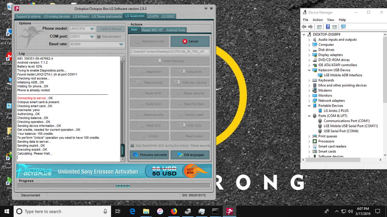

pag ok na yunit sa touchscreen proceed sa unlocking sa octopus na at need 100 credit to unlock
or gumana nga ang touchscreen pero naghahanap ng pin code..
need to flash na sya sa octoplus...using that file ...

then do again from the begining ng root...
