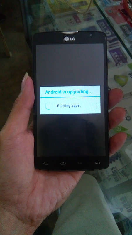

una sa lahat para malaman yung compatible version ng phone pasok kayo dito itype nyo lang imei ng phone at ibibigay yung exact firmware ng phone
check imei​
pag nakapasok na select CHECK IMEI

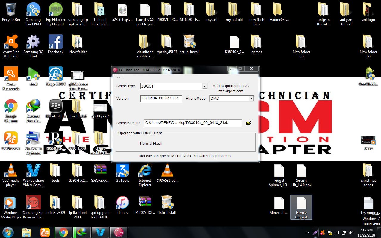

ito naman yung exact firmware na phone na tanggap ko
D38010e_00_0418.kdz
LINK HERE​
INSTRUCTION​

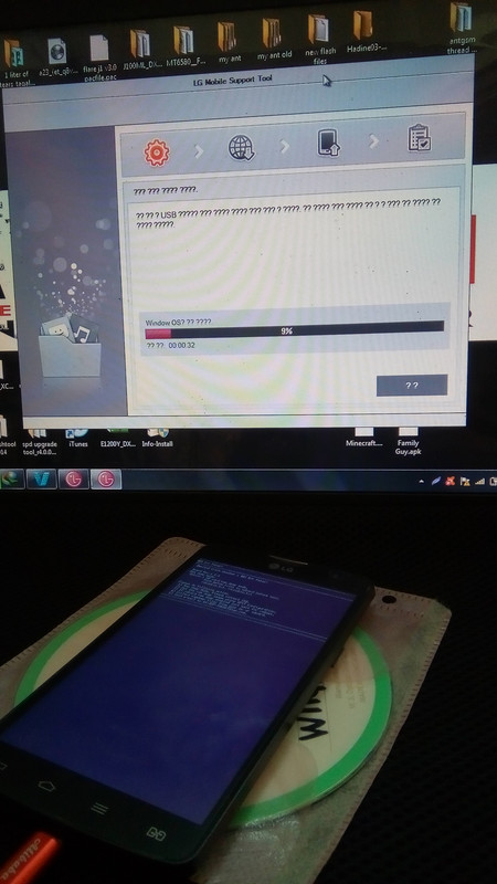

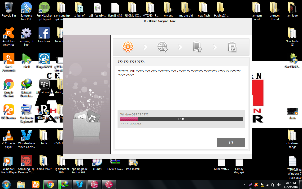

select KDZ file
normal flash
start
power off the phone
press volume up
insert usb​
