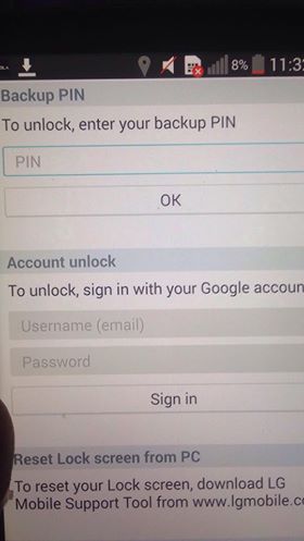

pincode and google account sign in
walang hard reset
walang recovery
no other way re flash

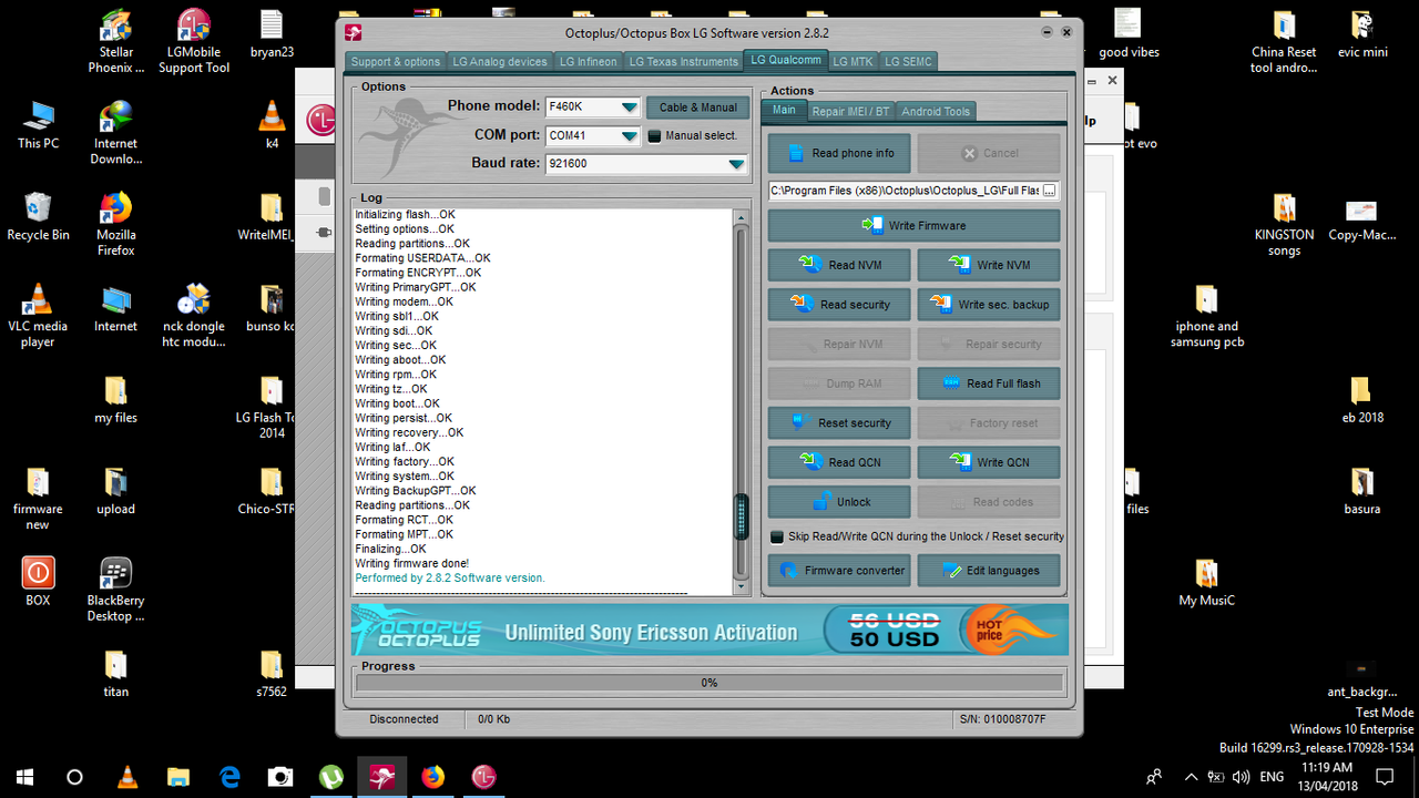

open octopus lg tools
choose f460
lagay mo na ung oct na files
click write fimware

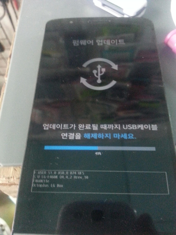

remove battery
insert it back
hold mo ung volume up for 3seconds bago mo insert usb
mag ddownload mode na yan
no need p999 na cable
remember no need p999 na cable

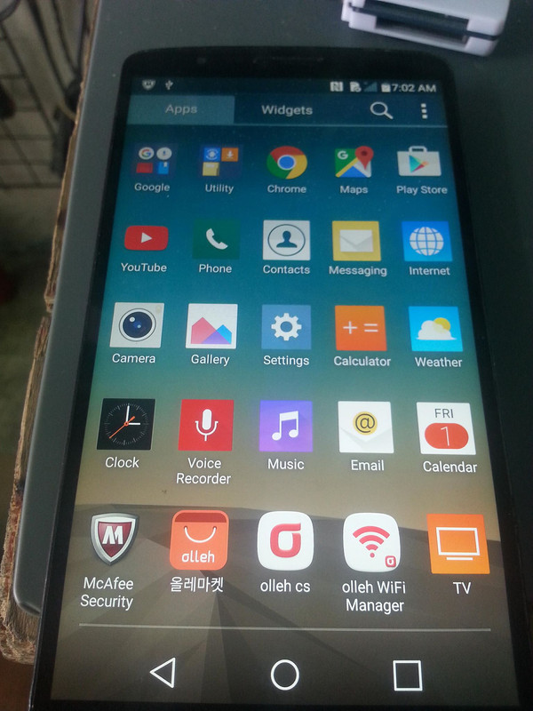

patunay
walang hard reset
walang recovery
choose f460
click write fimware
